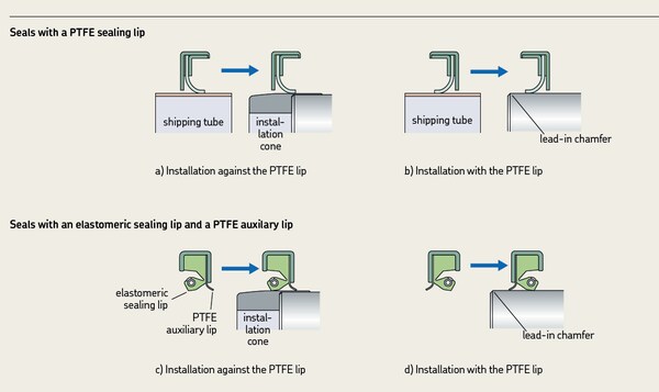

Derek, if those seals are PTFE seals, they have to be installed dry (not wet) and they must normalize to the shaft for 4 hours before any rotation.
From SKF
https://www.skf.com/us/products/indu...lications/ptfe
Installation
Installation procedure PTFE lips do not have the same elastic properties as rubber lips, which makes them more susceptible to damage.
Therefore, special care must be taken during installation and handling to prevent damage and help ensure proper operation and function. Shaft features such as keyways and splines, as well as drill holes, ports and sharp-edged shaft steps have the potential to damage PTFE lips. Whenever possible, these obstructions can be covered by using thin-walled installation tools made from plastic or metal. PTFE lip orientation during installation will determine the installation method.
Seals with care must be taken during handling and installation see for visualisation: Fig. PTFE seals.
Installation is more difficult when the shaft is installed against the PTFE lip (Fig. PTFE seals: a and c). This type of installation becomes even more complicated when the hardware is difficult to access or visually obstructed and may not be possible if an installation tool cannot be used. In any case, when the shaft is installed against the PTFE lip, SKF recommends the use of an installation cone or “bullet”. In lieu of installation cones, longer than normal lead-in chamfers on the shaft would be required. However, shaft features that could damage the seal (keyways, etc.) must still be covered, possibly with tape. If the shaft is installed with the PTFE lip, a smooth, burr-free radius or chamfer on the shaft end is all that is required, provided that no damaging shaft features are present as noted above (Fig. PTFE seals: b and d).
Some seals have two PTFE lips facing opposite directions. In this case, installation is always against one of the lips and an installation cone is recommended.
The crankshaft hub seal and the rear-mail seal are both PTFE seals.
