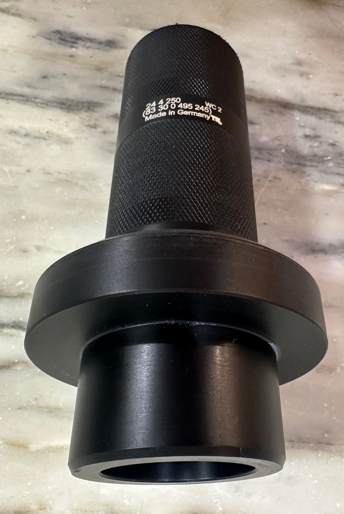

Thanks - It's a great thread and I've referenced that when I was doing my engine in-and-out, but I didn't see a link to the seal tool. I have found the AGA seal tool kit for the output (axle) seals. This doesn't seem to apply to the input (torque converter) seal. The TC seal seems to sit with the front edge lined up with the front edge of the housing, but I can't tell if it's really flat or maybe recessed ~ 1mm ... The axle seals definitely sit in 2-3 mm.

its not this?

That’s exactly the tool. Just can’t find it for sale anywhere….

Think its this one: https://www.ecstuning.com/b-genuine-...i/83300495245/
Old part number 90880244250
Dirft or Dorn usually means alignment tool in germany/MINI part title

Got the tool from ECS Tuning...
Just got the tool and an official MINI input seal from ECS Tuning and will start taking the engine out next week. Here are some photos to hold you over... It definitely does not recess the seal into the housing at all since it's wider than the seal OD. I'm guessing it will sit staight on the input shaft - you can notice it has two different size counter bores which I assume is to keep it straight. For those arguing about lubricating the seals, the official MINI seal comes with the ID pre-lubricated. Looks like a lithium grease and not specialty transmission assembly lube. For those curious about the tool It has both the old 24 4 250 part number (244250 or 244-250) and 83 30 0 495 245 (83300495245) part number. It feels like carbon filled nylon. Definitely not metal. Was turned on a lathe.
