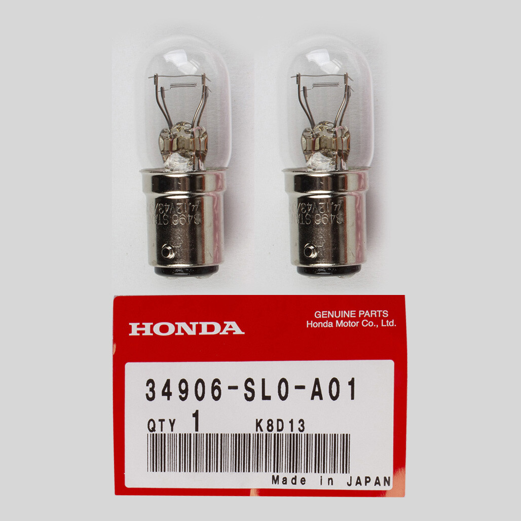

Best/Brightest bulb I've found is a Genuine STANLEY branded OE-Honda bulb... They are brighter and more durable... PN: 34906-SLO-A01... Ebay for around $17/pair shipped.
Work great. Rated at 27w ... but in real life... after a couple of month "burn in" are noticeably brighter than the 2357, and much brighter than the 1157 bulbs... and don't break the bank... AND... ZERO chance of bulb warning or flashing.
