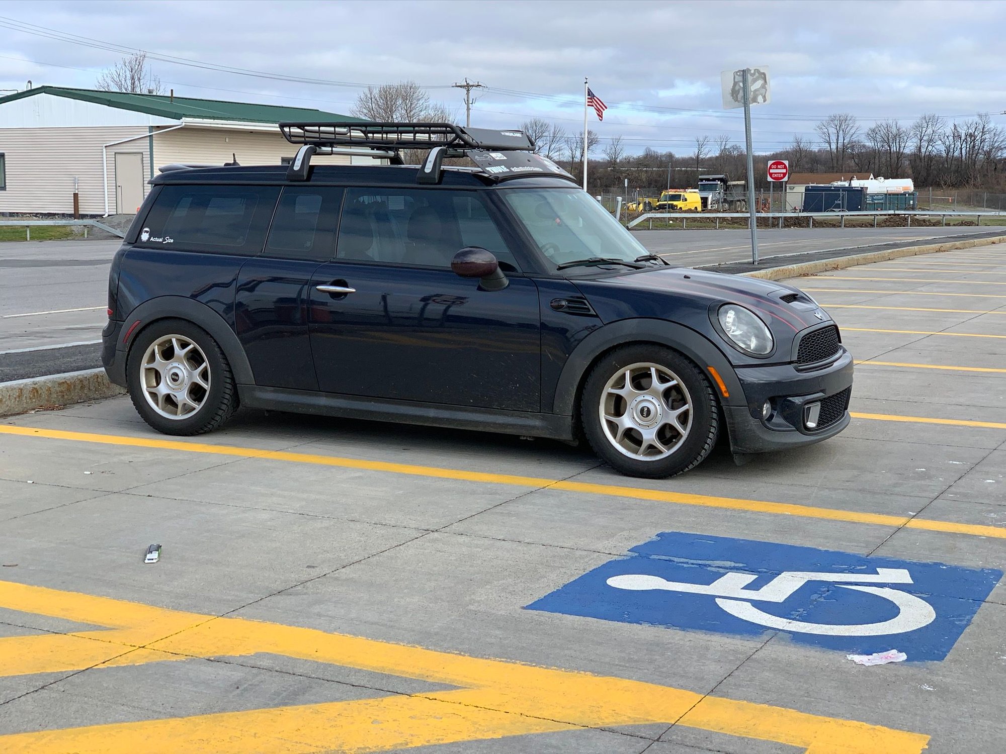

I would also suggest going with 205/55-16 tires.
I have used 205/55-16 snow tires on my Clubman. Lowered on coil overs with 8mm spacers, and I had zero rubbing issues.
Thanks much for that info and those pics! I don't know for certain what "Lowered on coil overs with 8mm spacers" means technically, but I'm guessing/interpreting that it is some sort of lowering of the car and so if you've been able to lower it some and still use that size tire fine without rubbing, then hopefully I should be fine too.
