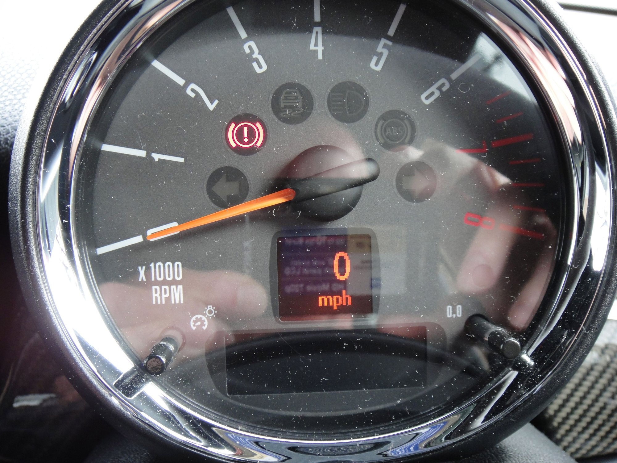

I have an 2013 R56 JCW.
Sorry, I feel like I'm being a little thick!
Insert my key fob in the dash, but don't start the engine. Just connect the battery charger and that's it?
I don't get the picture of the key, as shown in your photo.
I've taken two pictures, just to help explain!
This is what I get in my display, with the key inserted.
Key inserted like this.

Yes, insert the key fob into the ignition without turning on the vehicle, and plugin/attach your battery charger/tender.
