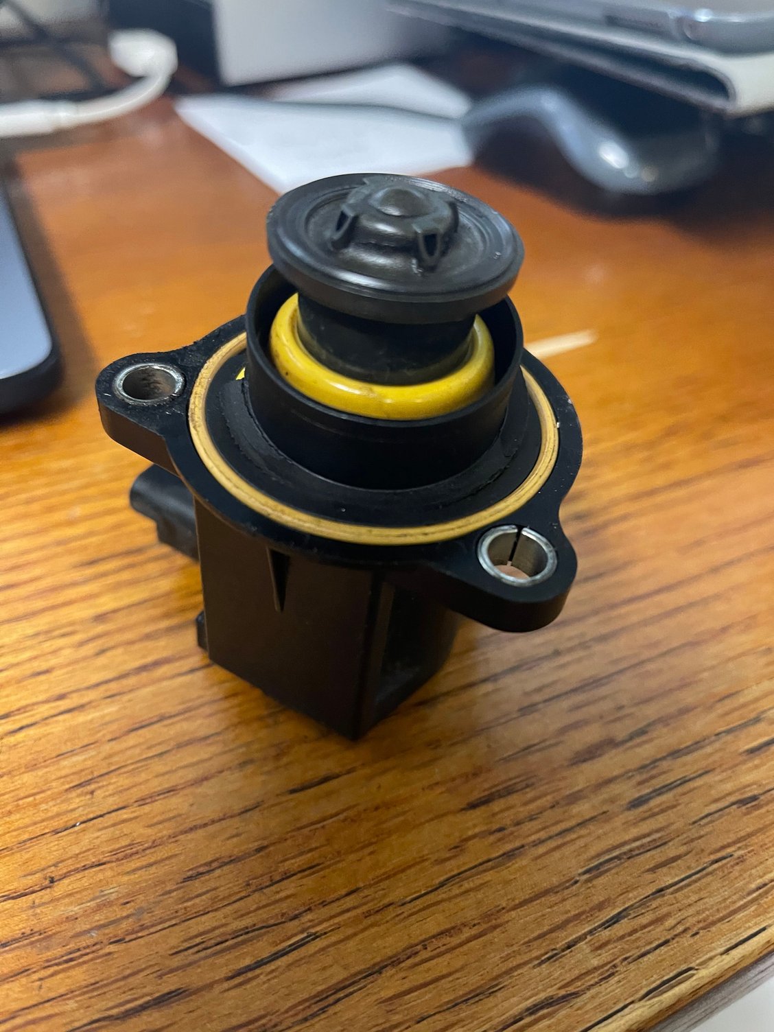

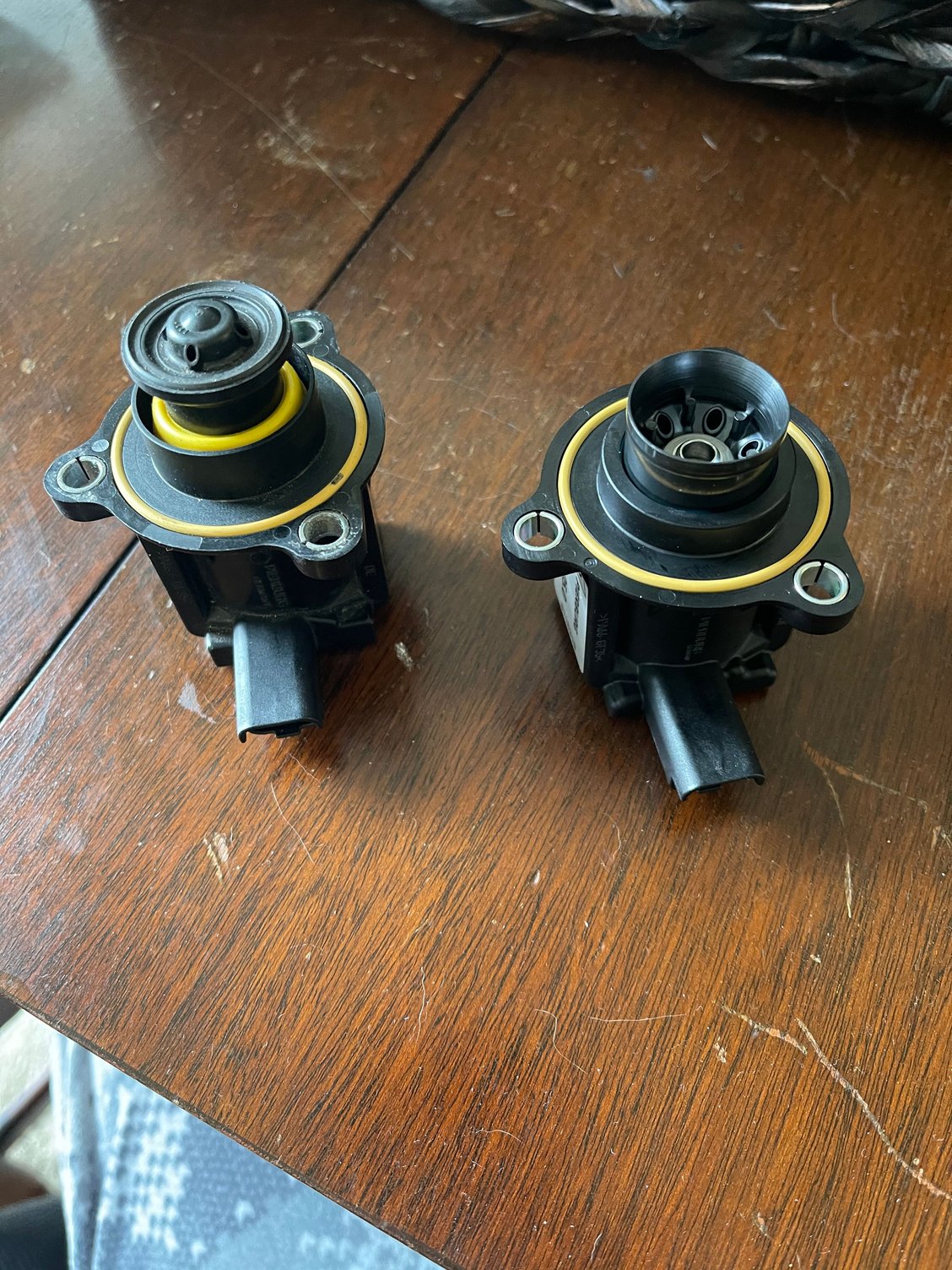

Originally Posted by Bruce/Fl
So, I assume that this being in two parts is a problem?
that would be why.
This is what both versions should look like. ECS and Amazon are very close on their prices, just make sure if you use Amazon that you hunt for the mini part number.

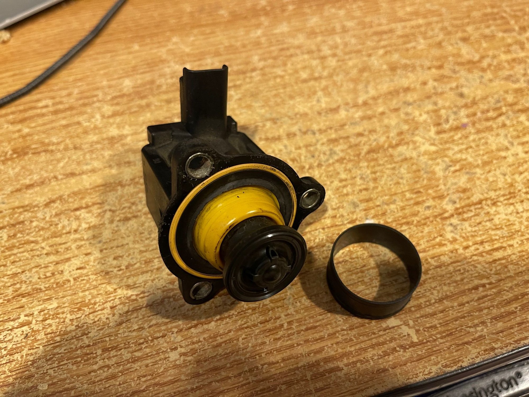

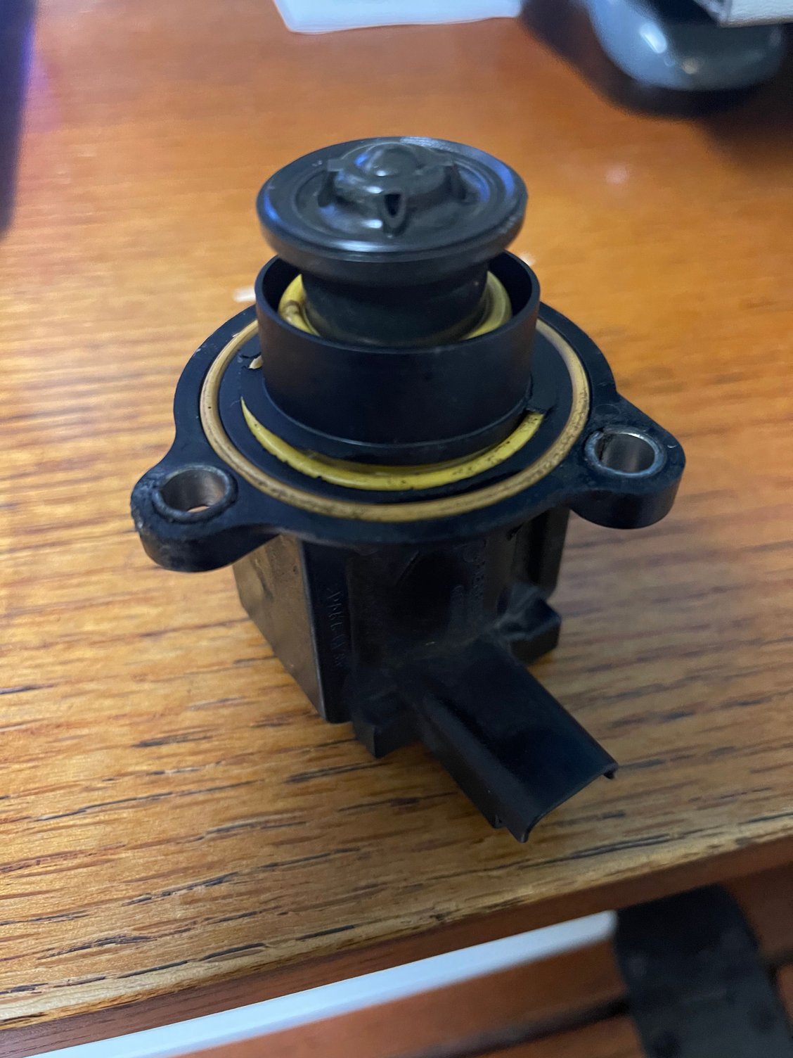

This is mine that went on me 1/4 mile in on the Dragon. 1st and 2nd gear all goods, the shift into 3rd I heard the DV making some funny noises, and half engine light. If I kept it out of boost I could keep the half check engine light off, and yes I limped her back to Cincinnati. I’m running the newer version with Alta spring right now and carry the old version as a spare.
