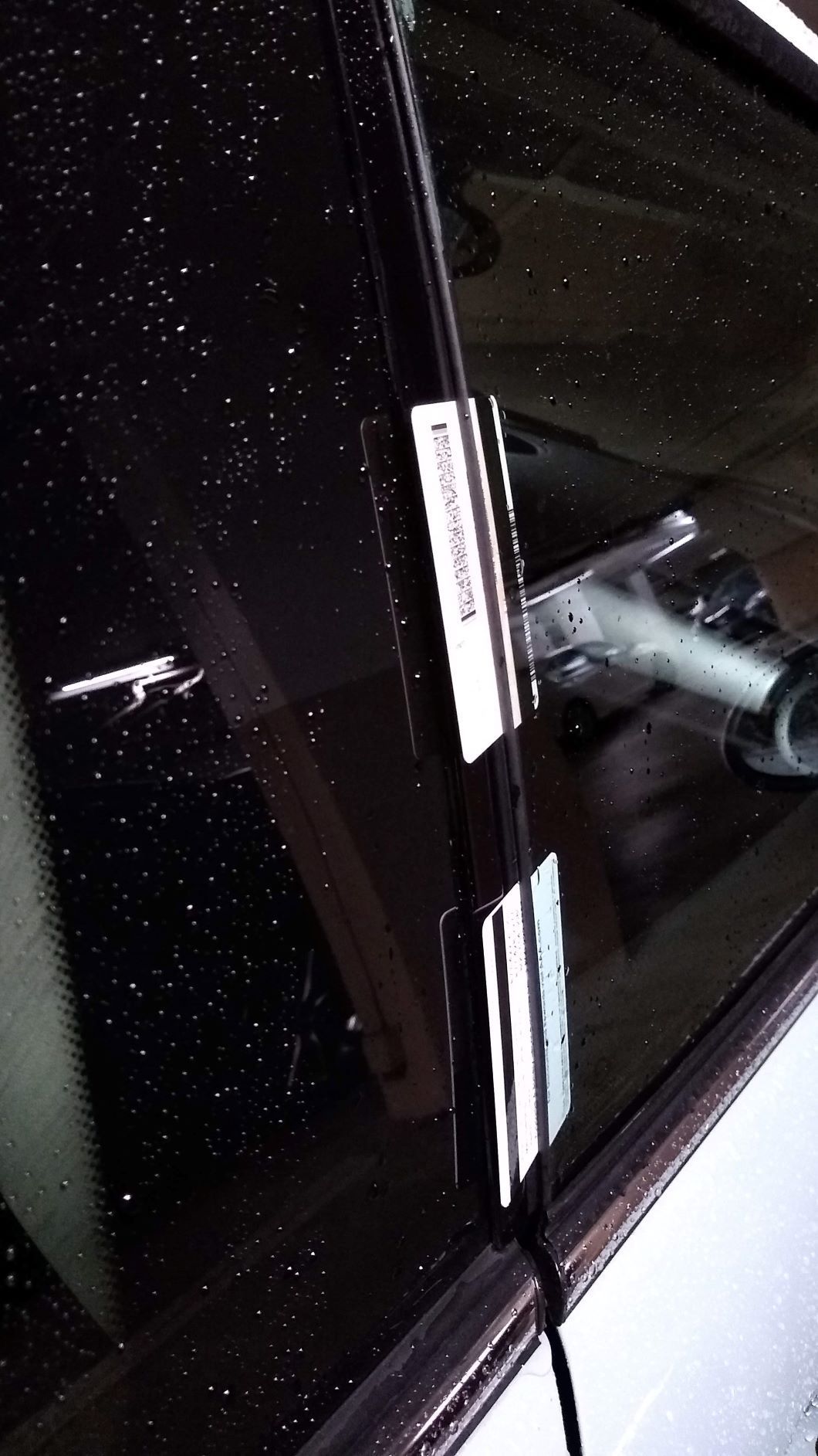

I have a dilemma. Any advice would be deeply appreciated.
I recently bought a 2013 MINI Cooper from Shift, an online dealer. $11,000+tax. 39k miles. No accidents on Carfax. Good oil change history, averaging 10k miles between changes. Clean. Shift has a 7-Day return policy. My return deadline is this Wednesday, 01/27/2021.
After I bought the car, I took it to a reputable MINI specialist (MINICorsa in the Los Angeles area) for a Pre-Purchase Inspection. Their recommended repairs total $1,000, mostly maintenance type issues: needs new belt and waterpump pulley ($350), new spark plugs ($150), and rear brakes ($400 for new, although the current brakes should last another 4,000 miles). The AC system probably has a leak, though MINICorsa doesn't think it's a big problem. (I asked about the AC issue in a previous thread here.) Overall, nothing horrible.
My biggest concern is a small gap (about 1.5 mm) between the back, vertical edge of the passenger window and the frame. See below for photos. I drove the car in medium rain for about 30 minutes - mild seepage. Heavy rain or carwash will likely cause leaks. Definitely more noise.
I took the car to several repair and body shops, including a MINI dealer. Their advice are conflicting, basically breaking down into three categories:
  • They don't know why the window gap exists, thus they'll need to open up the door to examine the inside. $200 for the diagnosis. Actual cost will depend on what they find.
  • They can open up the door and adjust the window for $300.
  • The window cannot be adjusted. (Is this true - that R56 windows cannot be adjusted in and out?)
Basically, I have two options:
  1. Return the car to Shift - This is the simpler solution. But I've been hunting for a used MINI for more than two years. It's hard to find one that fits all of my criteria: my preferred color combo, 2012+, under 40k miles, good Carfax, fair price, etc.) This one is ice blue plus white roof - one of my favorites. I'm already attached to it.
  2. Keep the car. Try to fix the gap by taking it to my choice of shop. But if the fix is going to be too expensive, like more than $300, then I'll just try to live with it.
My head says door #1 to prevent headaches, but my heart says take a gamble and go for #2. What do you think?
Thanks!

Is there a chance it's coming from the door that doesn't line up (prior unreported accident)?
If the car is low miles and in good shape I would probably not return it. Are you going to a Mini independent shop, I'd say a good one should be able to tel you with more accuracy.

It's possible the culprit is the door since the chrome trim doesn't line up. Some shops thought the door was misaligned, but other shops thought the door was ok since the painted parts looked fairly flush with no unusual gaps.
I went to two MINI specialists, Minicorsa and The Haus, both with great reviews on Yelp. Minicorsa referred me to a body shop, which estimated $300 for an adjustment. The Haus said they'd have to open up the door to diagnose. If a clip is broken, the regulator would have to be changed. They also said the window is adjustable up and down, but not in and out.
One shop pointed out that someone had drilled two holes in the door for paintless dent removal, thus it's possible that something internal got damaged by the removal process. There was probably no big, unreported accident on the door since everybody noted that the paint is original.

I might try adjusting the door latch striker plate (on the body) inward just a bit, see if the door might just close a bit tighter, pulling that glass tighter to the weatherstrip. In the one pic, it looks like the door sits slightly out from the body. Worth a try, at least.

I was in a very minor crash with mine which actually worked out well as everything from the door to the bonnet ended up getting repainted. While the shop did a spectacular job on the painting, the window adjustment somehow got off a little and its about 2 mm shy of going up fully.
I should’ve taken it back but ended up letting it go. The adjustment for fore and aft is easy but elevation and, I believe in-out, requires taking the outside trim strip off and special BMW/MINI specific tools.
No wind noise and it only drips a tiny bit in the car wash, never from rain.
also agree, see if the whole door needs to be adjusted a tiny bit, it might be easier.
Also also keep it 2013 is a good year. Mine’s just hit 100k and has been one of the most reliable cars I’ve had.

Is the glass genuine mini glass, should have mini emblem on the glass by the lock. Long story short, someone busted my window out and I got a replacement done a safe auto. My gap isn’t that bad but was in the middle of the window and about 2 inches long. They tried and tried and got it as close as the could. So I went and picked up some foam tape and placed in my problem area and it has been good for 6 months. Windows are tinted so you can’t see it when rolled up and when rolled down you can barely tell a difference in color. I have tossed around the thought of junkyard hunting for a door and glass.

Thanks for the suggestion. I'll mention it to the mechanic if I repair the door. Always better to try the easiest fix first.

Yes. Genuine MINI window.
