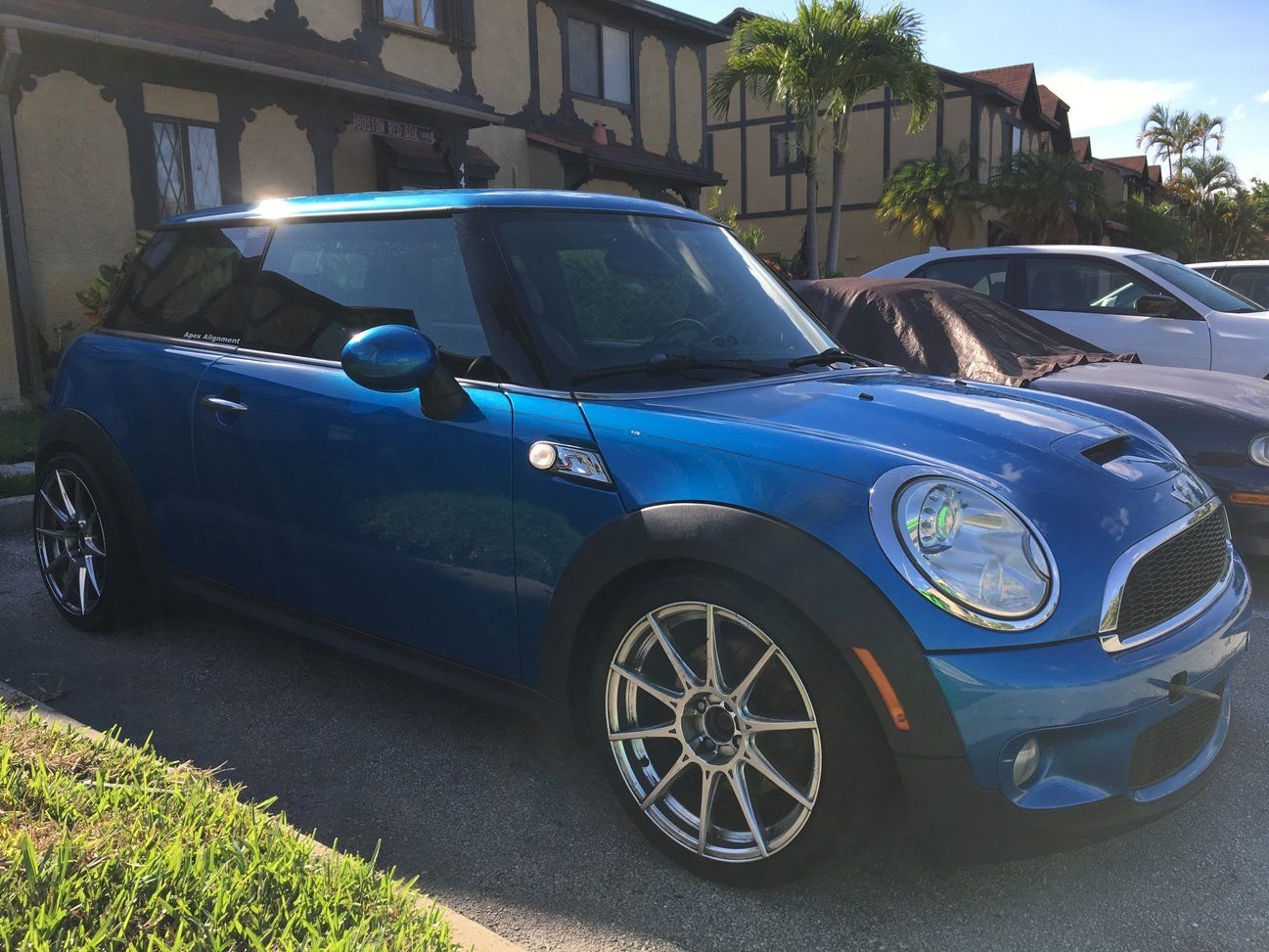

Hi guys. I'm back after a 6 year hiatus.
I picked up this laser blue 09 MCS 'premium package' from user Dr. Spade in Florida. It was an 8 hour drive one way, but I'm happy to have the project.
And project is putting it lightly. Battery dead, bald tires. He says his mechanic had the MAF and intake parts. So it runs...badly.
He told me it needed the oil filter housing fixed, but all I'm seeing is a big coolant leak. Which I have discovered is the plastic pipe going to the pump. So I've ordered a bunch of parts and hope to make some progress later this week.

Looks good, hope everything is an easy fix. What all extras does it have, I see slotted and drilled rotors and it looks lower then my JCW springs. Good choice of wheels, Avanti Storms 17's in bright silver. That's what I roll on so I'm biased.
Here is what the seller advertised:
New or recently replaced water pump, high pressure fuel pump, thermostat, timing chain, valve cover, JCW clutch & flywheel
Mods: M Factory Helical LSD (best mod)
Manic Stage 3 Tune by Lou w/ linear throttle
Alta 42MM turbo (Borg Warner)
Koni Yellow Shocks
Swift Spec R springs
Hotchkis 25.4MM Rear sway bar
Hotchkis rear camber arms
Ireland Engineering front camber plates
Hawk drilled/slotted rotors
Hawk HP+ brake pads
BMW DOT 4 brake fluid
Advanti Storm S1 17X8 +35 wheels
Federal 595 RSRR Tires 215/40-17 (45 profile closes wheel gap and also fits)
Made 287/307 on a Dynojet on 84 degree day with 93 Oct pump gas

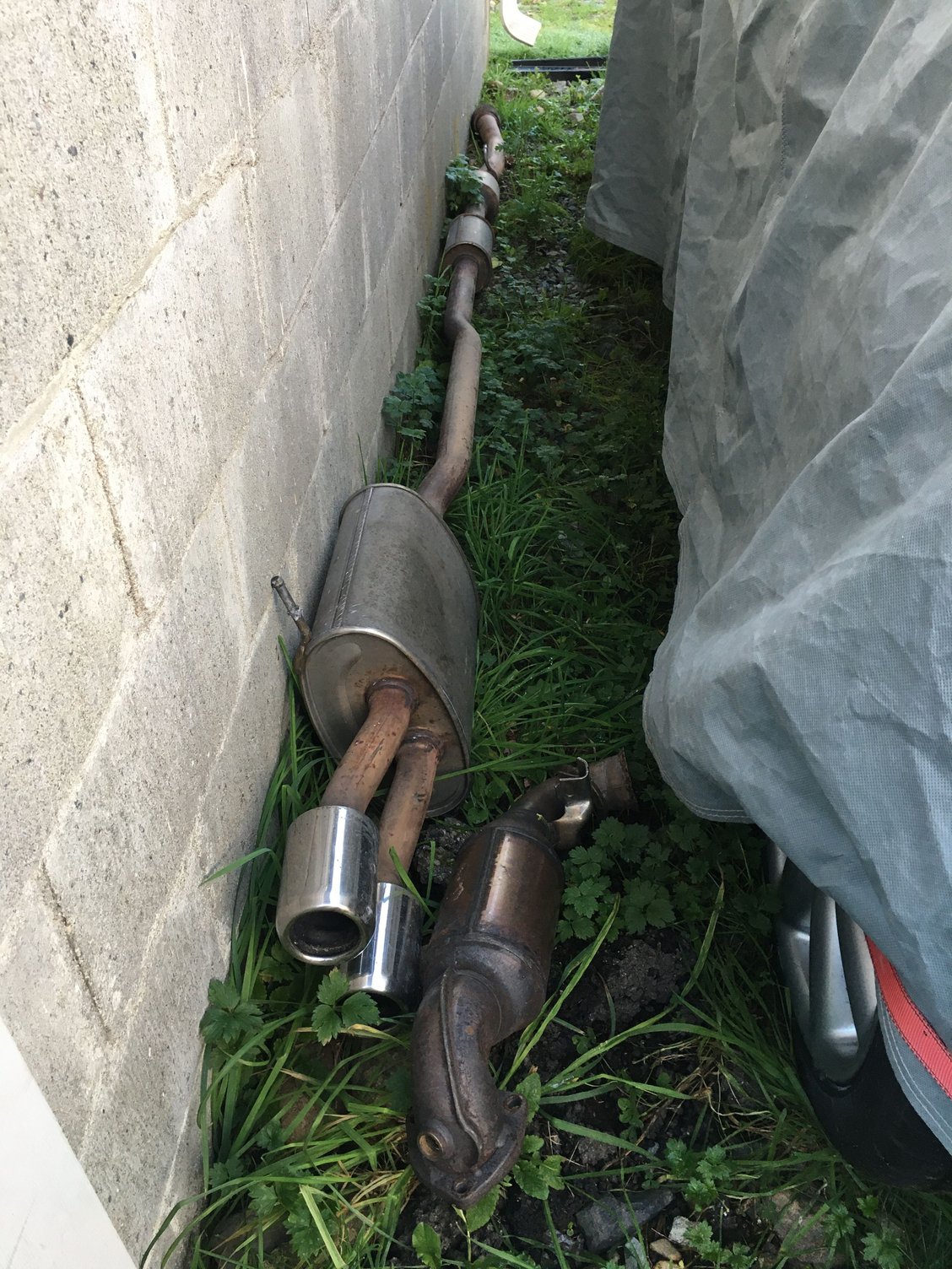

Stock Exhaust
Originally Posted by zrickety
Does anyone have a stock exhaust laying around? Or recommend me one that won't break the bank? This car has some kind of cobbled setup, even the downpipe looks made by a 5th grader. I've ordered 2.5" downpipe, but I'll need from the clamp back...especially the midpipe?
I have a complete stock exhaust.
