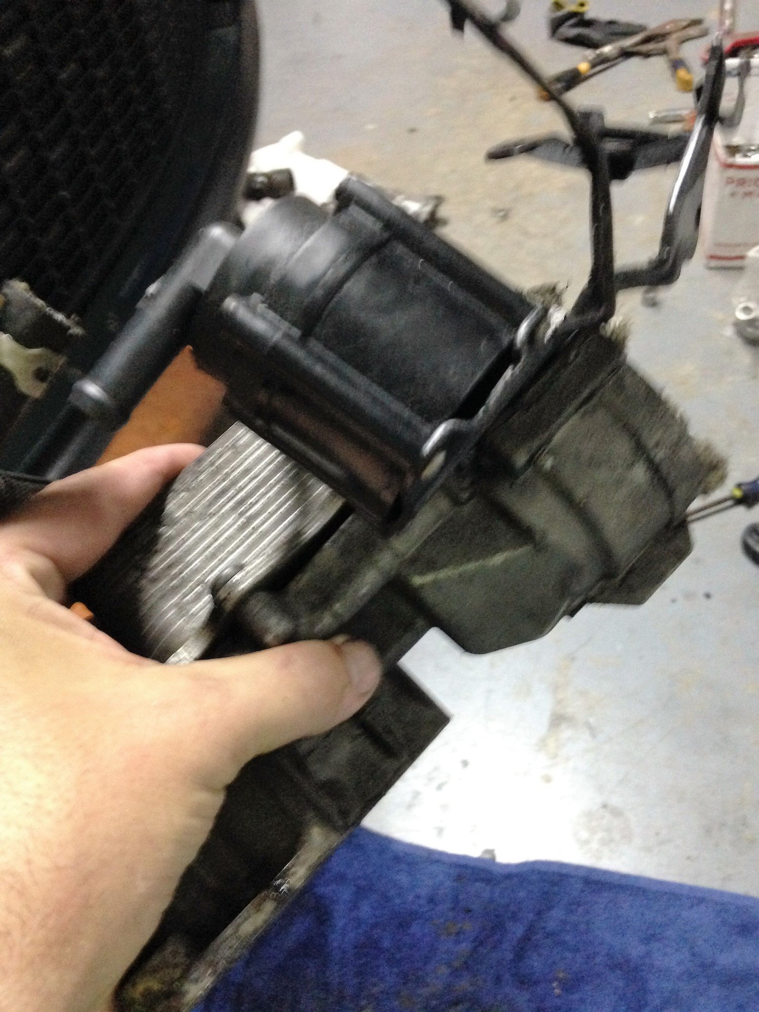

The oil cooler is attached to the oil filter housing, which is attached to the engine block. There are two sets of gaskets, you should replace both sets. If you already replaced the turbo oil feed line, then you have practice getting the heat shields off. The oil cooler is right next to the spot where the line attaches to the block.

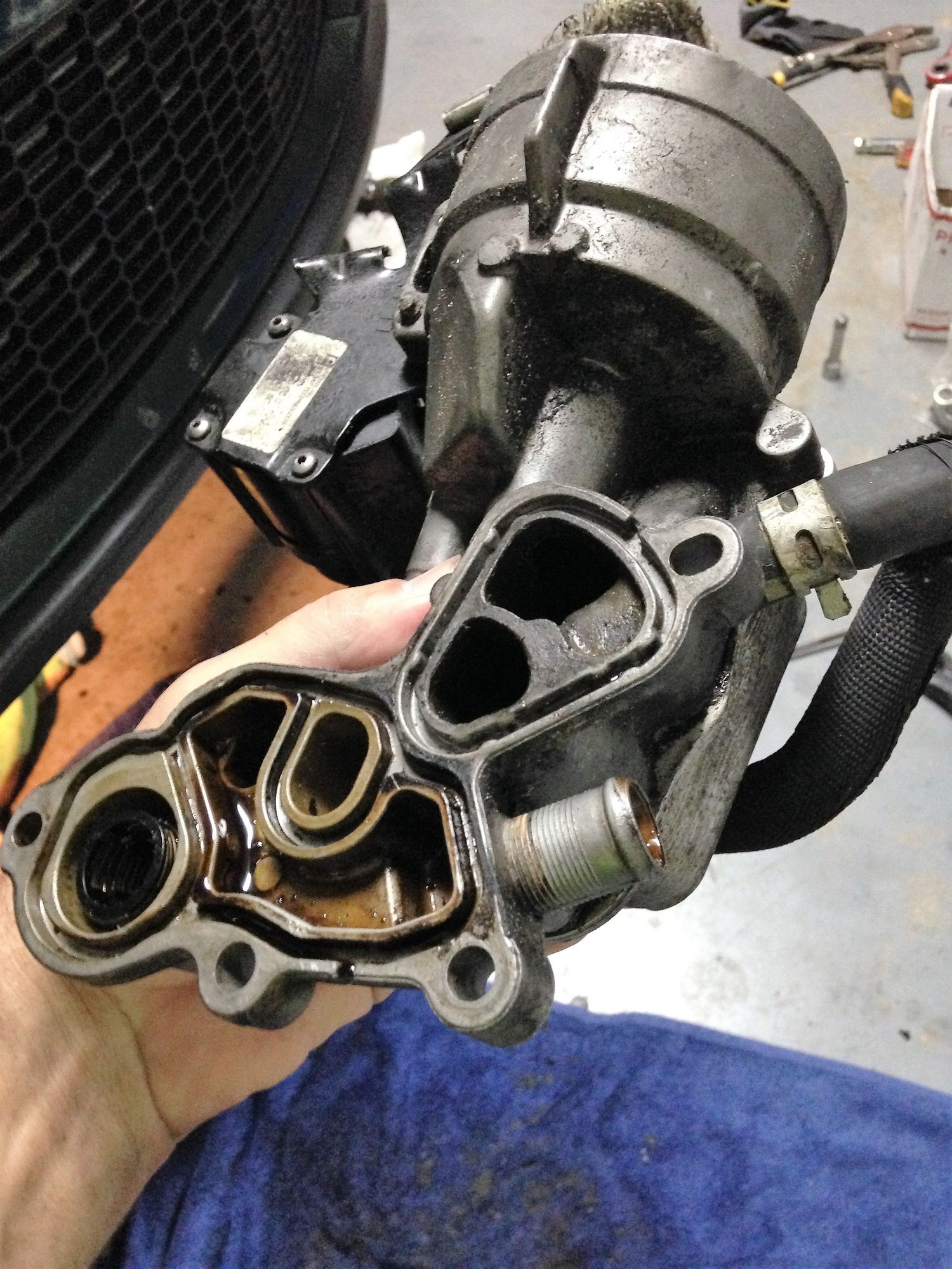

Just replaced my Oil filter housing gaskets when I replaced by turbo and downpipe.... my what a mess that was to clean up... oil caked everywhere below. Hopefully my oil use will return to normal!

Just changed my oil housing gaskets as well on Friday night...

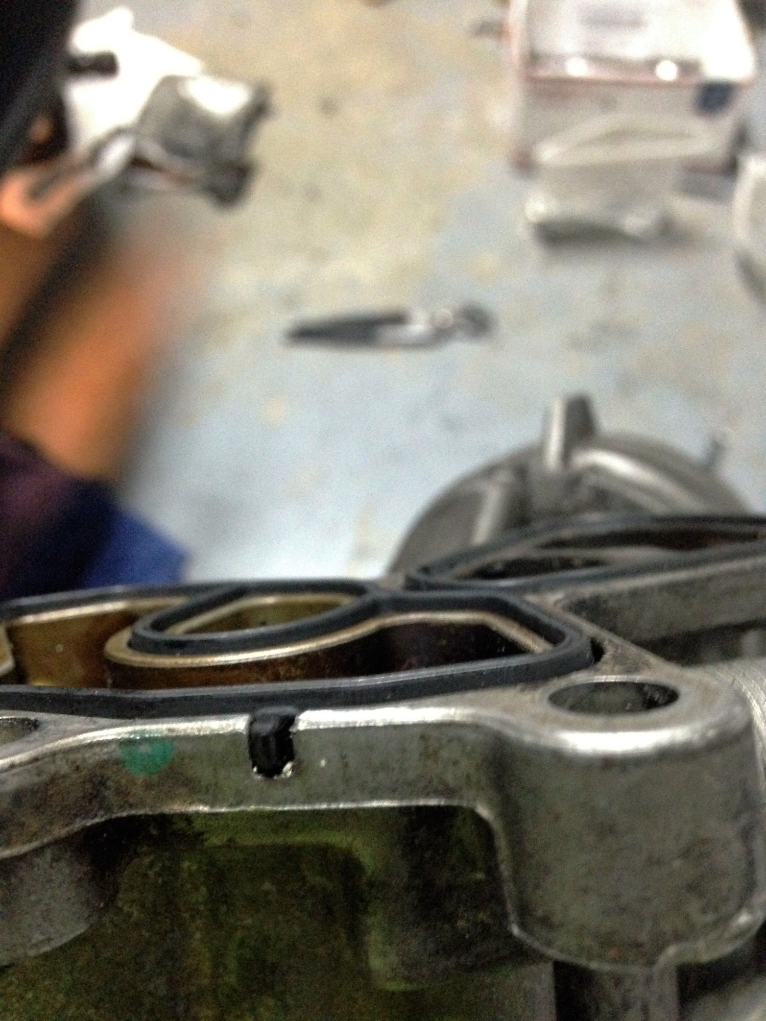

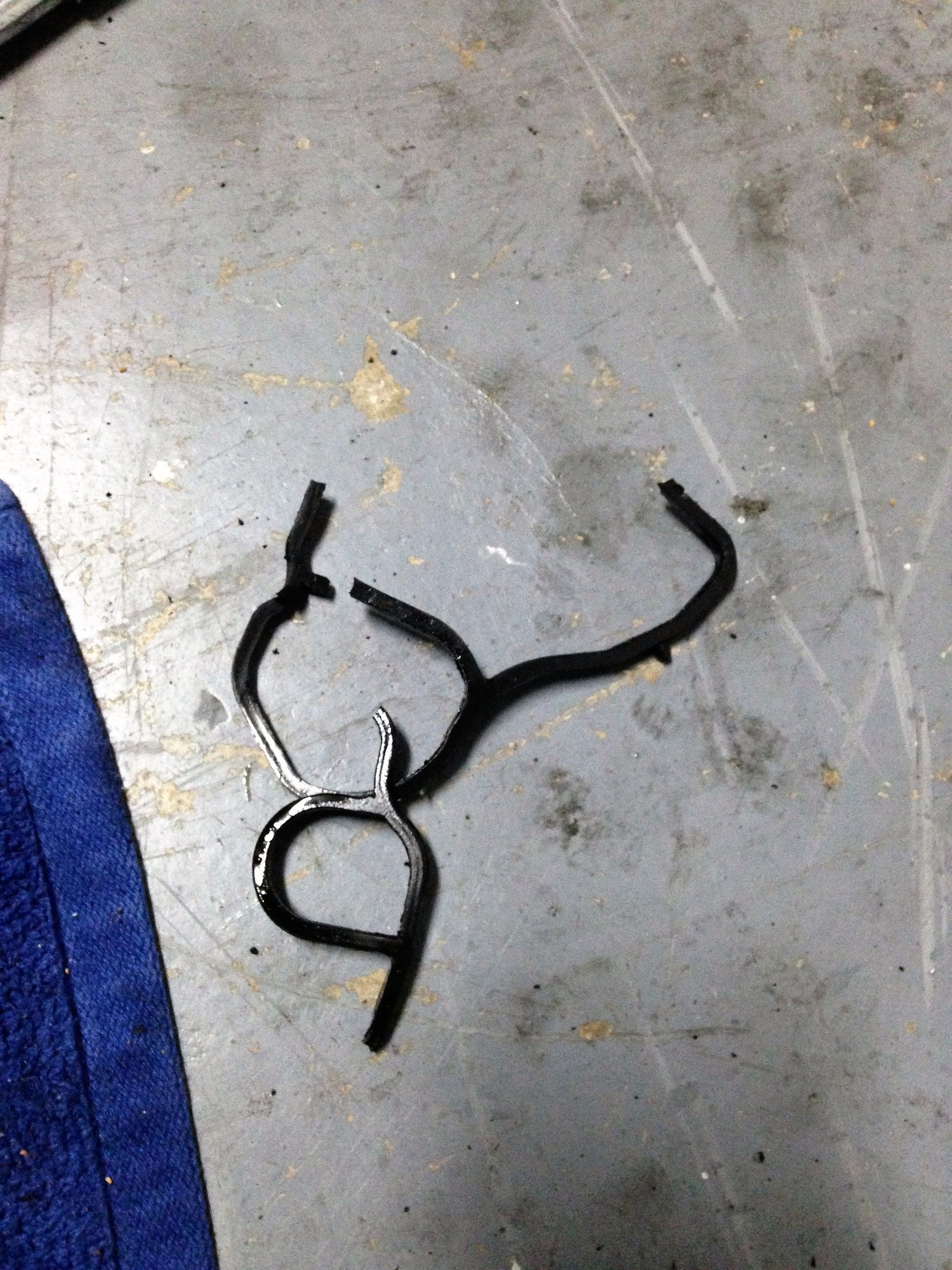

all the Gaskets were hard and one was torn...

oil cooler gaskets were really hard as well I changed Both....
