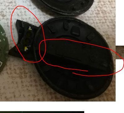

I have R56 (Europe) no unlock button on door handle.
I only have one key + a used key from another car which I would like to program / add a new chip to.
I bought a Zed Bull programmer and have read the chip as Type 46 - see image
I also bought the wrong Transponder type so will have to re-order.
My question
Where is the transponder chip? Does anyone have a photo of one in place which will make it easier for me to locate.
I am assuming I cannot re-program the used key fob.
Thanks in advance ColinK

I don't know where it is on the MINI but I've done this with several cars now and they usually hide it in the plastic somewhere. You picture isn't big enough and is too dark for me to see it very well. It looks like one of the plastic has a huge "rib" going down in the middle. What is inside of that plastic rib? This is what the transponder looks like. It looks like it would fit perfectly under that rib.
Keep in mind they hide them well because they don't want you doing what you are doing. You are stealing $120 from someones pocket.

Strictly a guess, but I would say one of these two places look like good candidates. Don't be surprised to see plastic on-top of them to hide it away from prying eyes. Provide a better picture of this half because it looks most promising. I've had a few where I had to break plastic to get to it. Some nowdays that actually melt the transponder INTO a solid plastic key to hide it and make it nearly impossible to get to and ensure $$$ to their pockets.
Let us know.

As you suggest, the chip seems to be on the board and not replacable. I havew confirmed there is no seperate chipin the case.
