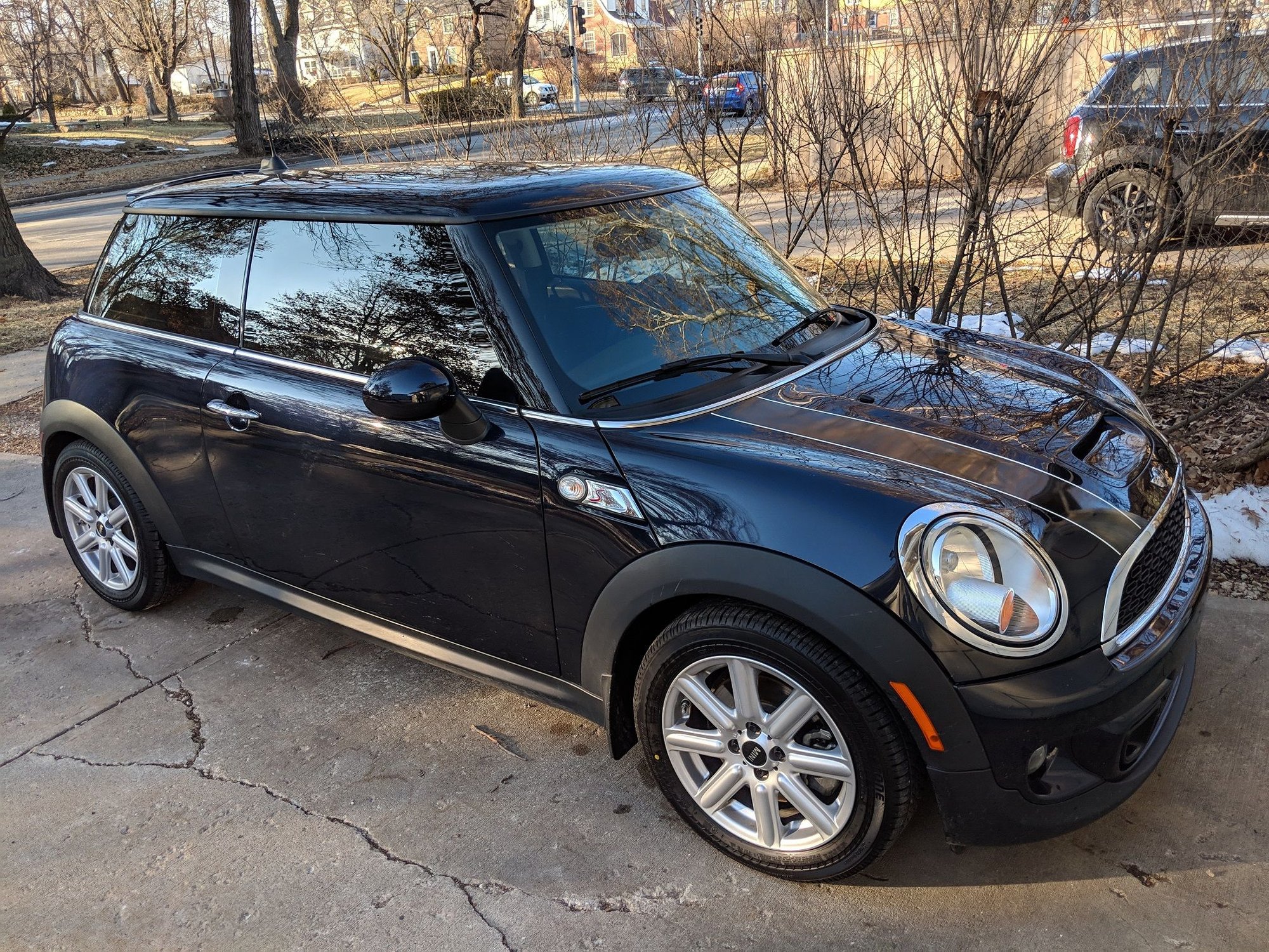

2013 MCS in Reef Blue Metallic. I resized this down some, but I don't know if it is small enough to display correctly.
very nice! Just like my 2012 👍

Thanks. I really like the color. Doesn't look too "boy racer" so it fits my age better.
The window sticker says the Reef Blue Metallic is a $1,000.00 option. I assume any color costs that. But, it seems steep.

Reef blue wasn’t very common, very classy color. Nice find. It’s also good that the thermostat housing was replaced. The only other thing is to keep an eye out for leaks. My 2013 doesn’t use any oil, but a friends does.
