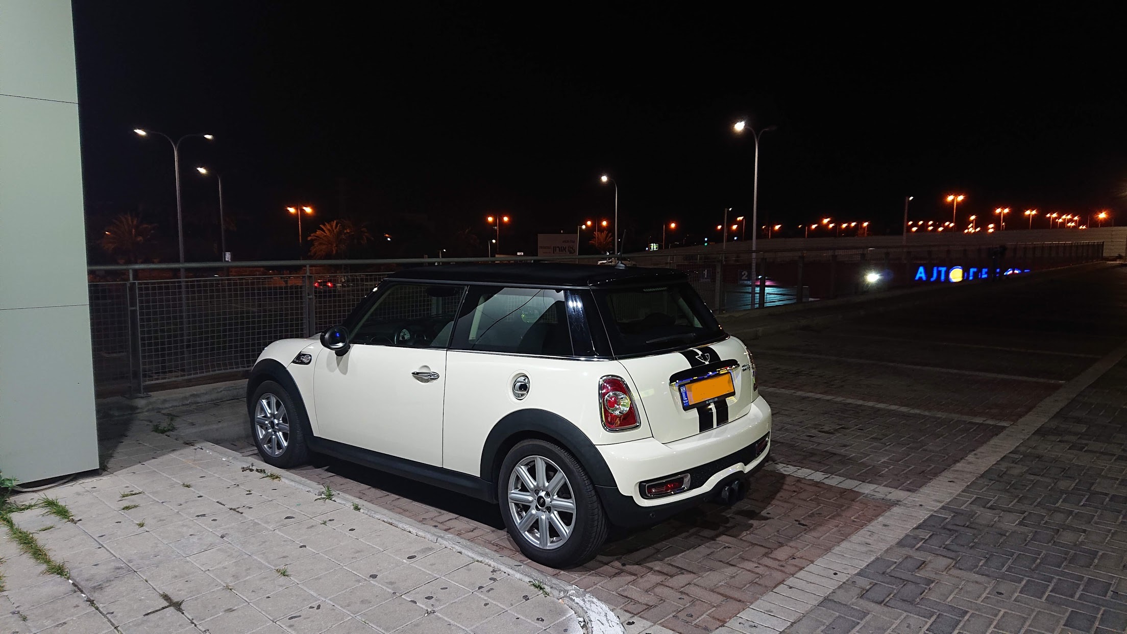

Hey guys, I got my Mini for around 3 months and I got some things that bother me and would like to change:
  • Wheels - Currently wearing 16" wheels with 195/55 runflat tirers which are terrible.
    I want to get OZ Ultraleggera 17 [black] with some decent tires. This is top priority for me, but also very expensive [around 2000$ in my country]
  • Coilovers - I want better comofrt and lower car, currently my mini looks like a 4x4
  • I got Remus exhaust but I feel like it isn't load enough for me... What would be the best solution? This is usually pretty cheap and makes a huge difference
A picture of the bride:

Welcome to NAM.
Nice looking MINI. You across the pond by chance?

From just looking at the plates it appears he’s not in N. America.
