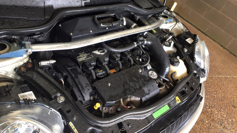

depends on how much money you want to drop! i would say hawk's over ebc's
intake's are kind of a hit and miss with the mini's
