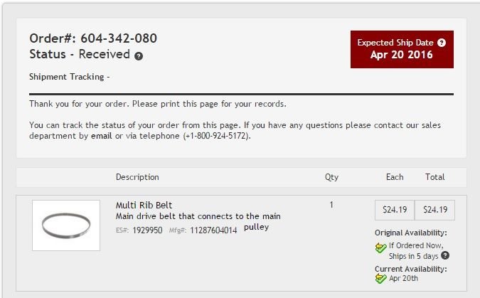

Originally Posted by 1004ron
All the belts that @ECSTuning has listed are good, but my personal preference is the Gates (Made in the USA).
https://www.ecstuning.com/Search/Sit...014/ES2975764/
Yes, I was reading a lot before buying the belt and I could see that Gates is the #1 in quality.
I ordered the OEM one just because it looks identical.
I'd have peace of mind with any of the ones @ECSTuning has listed, after-all, it sounds like you have a 100k on the OEM belt.
