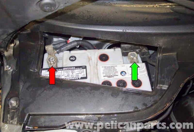

Can you take a closer up picture of the negative terminal? The one on the left in the image. I don't think I see the sensor on the back of it. If you view the image below (from our battery tech article) the green arrow pointing to the negative terminal. At the back of it you can see a black L shaped unit. That's the IBS.

Looks to be an IBS system. It could be that the plastic case around ours that you can see from the image above (post #12) is missing from yours. Definitely looks like it has the BSD interface and the IBS unit without the cover.
