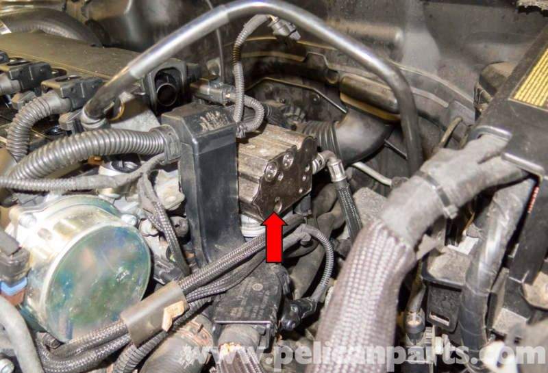

Also where is the high pressure fuel pump located?

The pump is mounted to the left side of the cylinder head (red arrow) and is driven by the intake camshaft. (Photo is from our HPFP DIY replacement)
