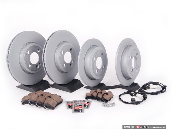

We have akebono / zimmerman sets for the Cooper S non JCW brakes.
http://www.ecstuning.com/Mini-2010-Cooper-R56-S-Coupe-L4_1.6L_N14B16A/Braking/Service_Kits/
