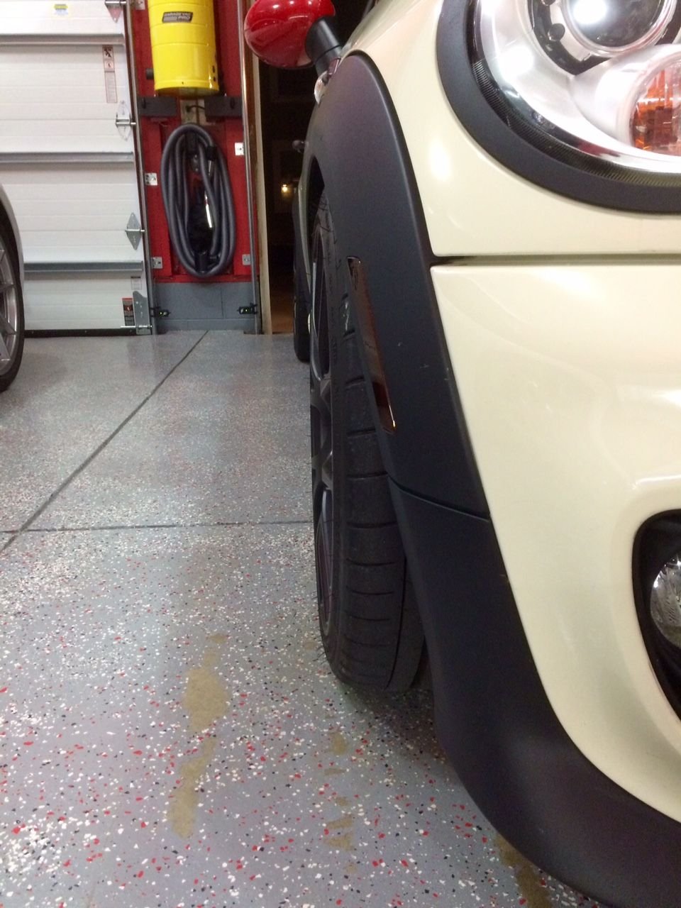

Old Aug 20, 2015 | 05:13 AM
minimofo's Avatar
minimofo
Joined: Mar 2014
Posts: 223
From: columbus, oh
here you go...
1st 3 pix are front wheels with ecs 4mm spacers.
2nd 3 pix are rear wheels without any spacers yet. i'll install the ecs 4mm spacers this weekend once they've arrived.
...rear wheels without any spacers yet.
Old Aug 20, 2015 | 07:55 AM
Posts: 36,719
Likes: 2,537
Looks great , thanks for the pics.
