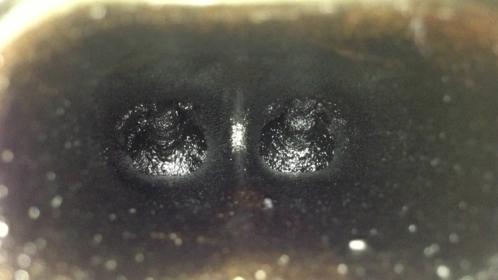

So I had my car walnut bashed (supposedly) in Feb. The car came off the road about a week later because I still had knock/missfire issues.
I left it with a friends workshop and arranged to get a few things addressed like timing chain, clutch and a few other things as well as obviously diagnose the missfire/knock. The engine was removed to make the whole thing easier.
Just before we decided to put the motor back in tonight, we thought we would double check the intake and discovered that it was quite badly coked up again.
Since getting the walnut blast job done, the car would be lucky to have done 300-500kms ~ 300-400 miles.
Could an intake valve really carbon up this much within that amount of KMS. To top it off I added a catch can just after the walnut job, so in theory that **** should be in the catch can (worst case).
Thoughts?

I'd like to think they shouldn't be, but with these engines, I'm not so sure. Also, catch cans as a whole do very little for carbon build up. That is unless you have a very intricate catch can set up.

you probably got hosed, and they assumed you'd never pull the manifold off to check.
does your engine consume a lot of oil? this would indicate bad valve guides, worn rings etc, in which case that carbon can build up faster than you'd think....but after 3-400 mi, I think that they likely did nothing, or a quick and minimal job.

you got ripped off . No way that is 3-4K miles , looks like 30-40K miles

The company that did it are being somewhat reasonable. The owner said he did it himself and has pictures of before and after, but it started getting more sketchy after he said he would take a while to get them as he changed phones since then.
He tells me he had to do both a chemical and walnut clean. I'm of the opinion that he just did the chemical clean because he ran out of walnuts or something. The catch can has no residue in it, and even while the car burns a little oil, it hadn't used any in that space.
Engine has also been compression and leakdown tested and comes up ok, I know they can be misleading with carbon buildup, but there should at least be some abnormalities in the test.
I've sent all the pics to the people that supposedly did it. Hope to get a positive response from them and not a "we did it, go away" response.

Actually I don't see carbon build-up on the valves, but they look like there are covered in a thin black residue. There are areas that look like there are lump carbon deposits about the valves.

They look similar to the shots circulating around on the net for R56 with carbon problems. Then again, the guy that supposedly did the job said he used chemicals as well, maybe the chemicals have broken it down a little and made it more of a sludgy mess.

That looks much worse, it doesn't look like walnut media was used, no one had this valves property cleaned. Obviously the chemical cleaner didn't come into contact with the area above the valves do to gravity.

It is best to have before and after pics verifying what was done...simple for the tech to do. We show the owner in person if they are present as soon as the IM is removed and a boroscope is inserted. Only way to prevent this is stopping all the ingestion causing it, and that takes a special separating system to do so. As far as severity and how quickly they coke up, just get anyone with only a few 1,000 miles on theirs to remove their IM and you will see how rapidly they do build up. By 10k miles most loke like heck.
