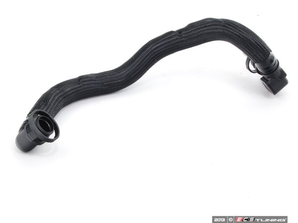

I'll change out the spark plug on cylinder 1 and check for vacuums leaks. Can anybody help me with a diagram to locate the vacuum hose?

That's the most common vent hose, but with a leak it throws a code most of the time.
http://www.ecstuning.com/Search/SiteSearch/11157612996/
All I can think of is that in the cold climate your throttle body might be sticking from gunk and you get a stumble.
It connects to the intake manifold. On the bottom
