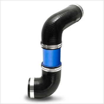

thak you all for the assurance. its been a good day now and after a few hours on the open road all seems to be fine. my next question is i would like to swap out the charge pipe entirely now to eliminate the noisemaker. now i know NM makes a new pipe however i would like to fabricate a setup myself and save a dollar. Are these forge hoses the same (not exaclty the sam but same usage) as
those found on the ends of the NM pipe?
You can do that, or just plug in the 1" pipe that feeds the noise-maker duct and be done with it.
Many ways to accomplish that, I ended up using about $5 worth of hardware plumbing supplies from Home Depot.
Pics here: https://www.northamericanmotoring.co...nhancer-2.html
Works like a charm.
No perceptible noise or performance change that I can detect to date.

DIY. Why spend $ on a blue pipe when you can plug it with a stopper and tighten it down. Just don't tighten TOO much or you could split the plastic tubing. Then you'll be SOL and need that fancy blue pipe.

decided to go with a black pipe and some fancy blue samco hoses instead. Could go with the stopper but wheres the fun in that. stay tuned, my hoses come in tomorrow and soon i should have some pics of the custom pipe.
