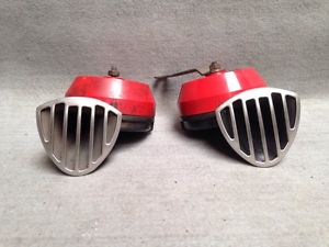

I finally installed my new/old Fiamms. I was hoping to find some stock connectors to use but ended up modifying the connectors that were on the original horns. I cut them down and ended up with connectors that aren't bad at all. The Fiamms I put on were some old ones I'd had since the late 80's. They still sound great and because the horns are screwed together instead of glued together, I was able to rotate the spiral horn thing on the horn mechanism and position the electrical connections where I wanted them. They sound similar to the original horns but are a bit louder and more strident. Now I can again let folks know they're being idiots.
They look like this but without the red plastic covers:

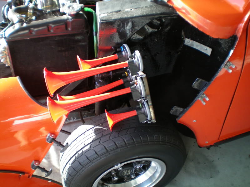

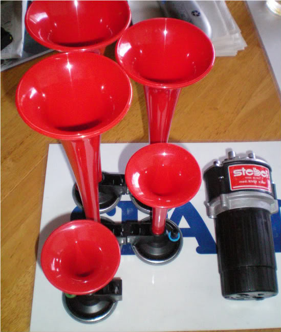

dem's not horns
these are horns
on my 79
they play a bar of the Colonel Bogey March
aka Bridge Over The River Kwai movie theme
