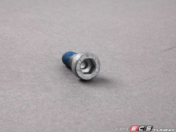

perfect thanks! now is it possible to purchase the bolts i would need to go back to stock?

Here you go: #3 in the diagram x 3
http://www.ecstuning.com/Search/SiteSearch/07119906392/ES2676731/
