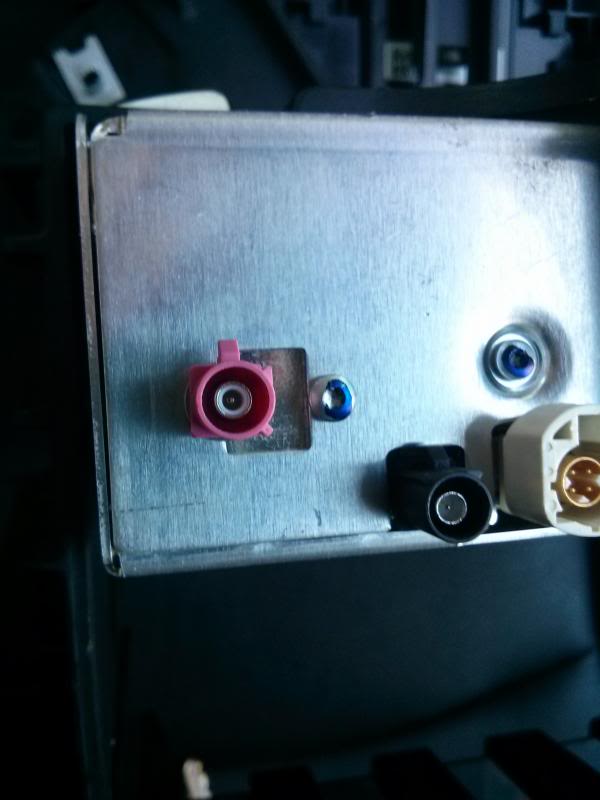

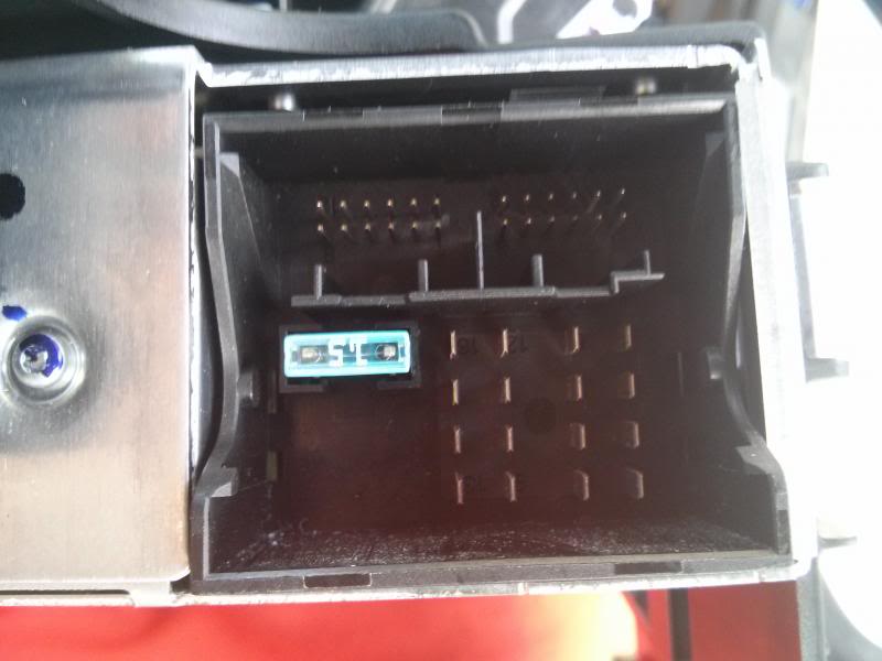

I put a LCI r56 radio into my 08 MCS and sirius appears to be already apart of the head unit. (it has the esn on top of the cd player so I guess no tuner is needed) Anyways, I need to get the sirius antenna connection from under the seat to the back of the cd player. Would this be the type of wire needed to use as an extension?
http://www.pasternack.com/fakra-plug...753h-60-p.aspx
Here is a picture of the connection under the seat and the connection on the back of the cd player to use for reference.

I don't have Sirius on my Mini, but I do on a couple other vehicles. That looks like what you need. The plugs look compatible and the impedance of the cable seems correct. Not a bad price.

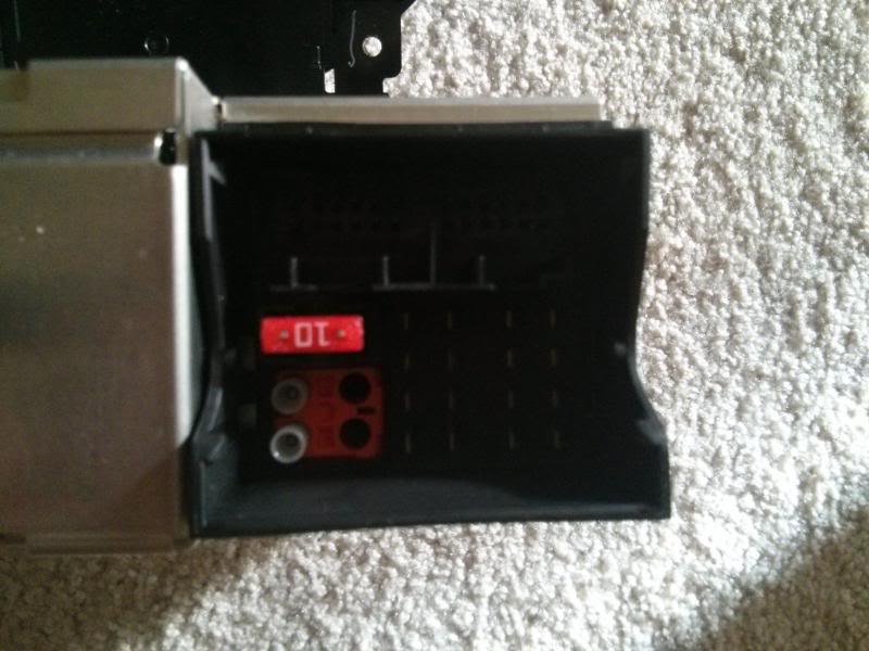

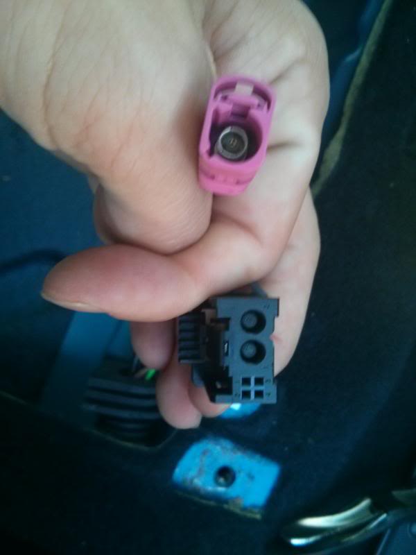

Here is a pic of the back of my original radio out of my '08. Everything except the radio antenna goes through the wireless harness, even the fiber optic input and output.

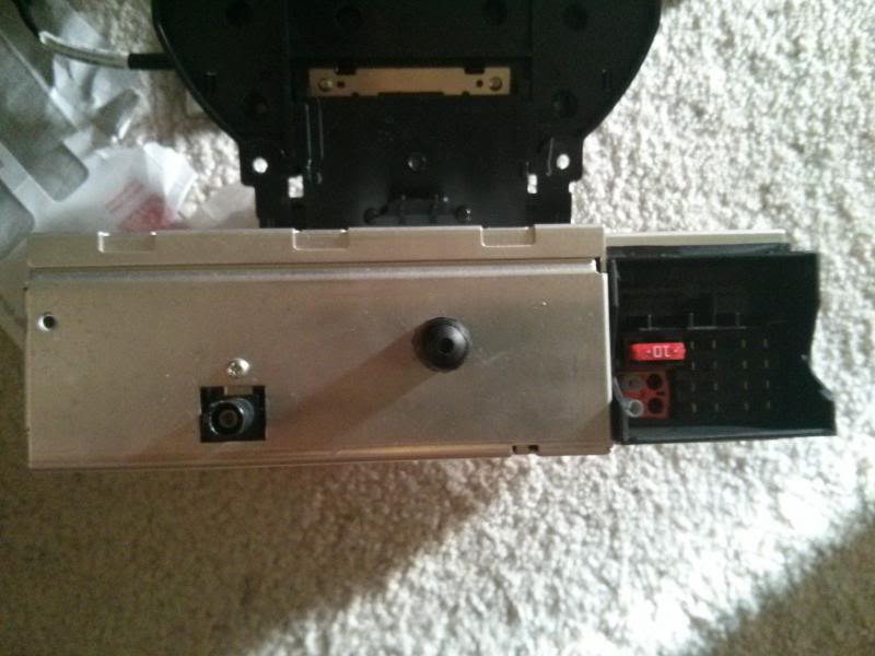

Now here is picture of the back of the radio out of a '12. It now has an antenna connection for satellite (pink), USB connection (white), and the radio antenna (black). If you look where the wire harness plugs in, there is no option to receive the fiber optic input/output.

So it appears I might just be able to hook up the antenna for satellite and enable sat through ncs expert to get it working. I've already checked the esn that is on top of the cd player for sirius and it comes with a free three month trial too.
