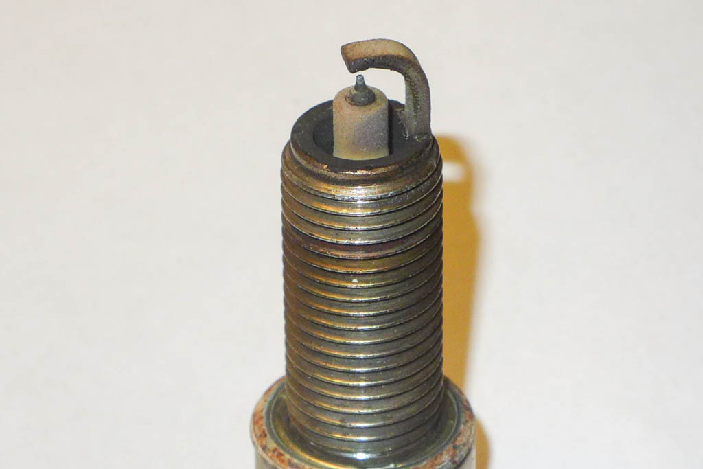

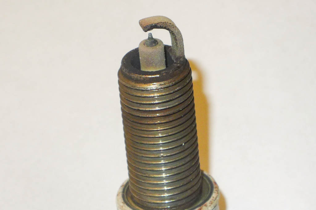

Only 41,000 miles but thought it was a good cheap maintenance item and I was itching to get my hands dirty.
Used the original NGK Laser Iridium's,ordered from Amazon. Got the socket from Sears online, all good to go.
I didn't have much expectation since miles were relatively low for spark plug change. so far with 1/2 tank gone I can say that my fuel economy is notably better. My miles driven + distance to empty is typically around 490 miles, but now around 510 (theoretical). I keep a record of MPG so lets see where it lands after a refill.
The car does respond and idle a tad better, but its hard the discern. If you've been debating chaning your plugs I would go for it. Don't wait for "100k".
The old plugs didn't look so bad, even coloring. Here are the pics.

Those aren't bad at all, you should've seen my plugs on the M5 after 35k miles...
