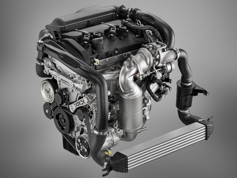

108 views and only 1 response? :( To the person above... I was thinking that to but really got to thinking about doing it myself and putting the money I saved on labor from a shop into tires or brakes that I need as well. Trying to turn lemons into lemonade I guess. I went out and was looking around on the car again tonight and noticed a piece of hosing with a broken piece of something attached to it. I traced it back to something... and curious if anyone may happen to know what it is. Its circled in the pic. The other pic is just a bigger version of the area. Its located almost right below the turbocharger in the pic.

Droc -
As for the component shown in the photos above, I think it's the auxiliary water pump that cools the turbo.

Originally Posted by Spridget
Droc -
Spridget
Thank you!
