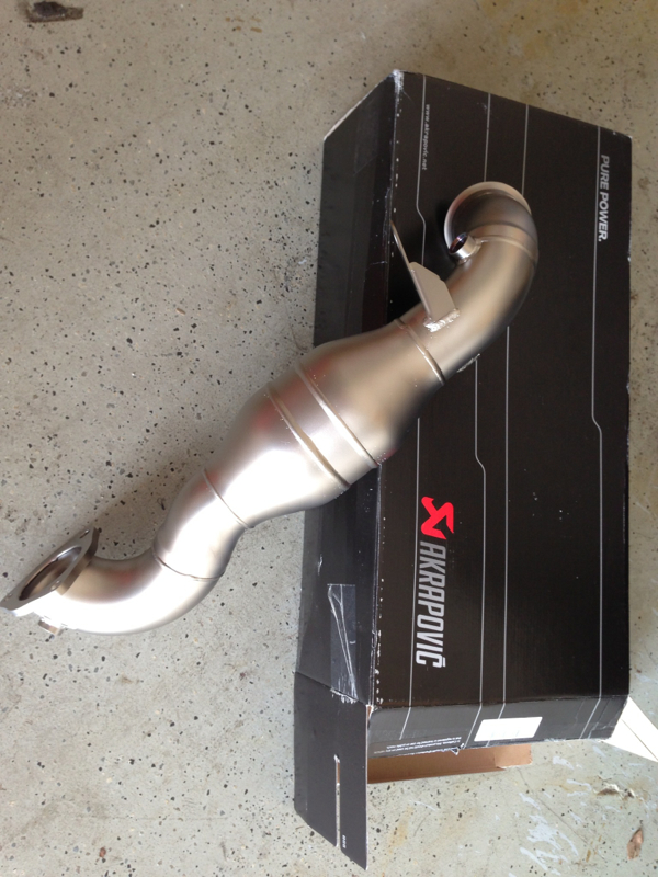

I was installing my new akra downpipe the other day and i broke one of the exhaust manifold studs due to overtightening with my superman like strength.. . Any ideas on how to get the remaining piece out so i can put in a new stud ? Any ideas will be highly appreciated ?

You can always use an easy out if you can get to the broken face of the stud to drill a hole in it to insert the easy out. In you photo it appears you can get to the other end of the broken stud and grind a slot using a Dremel tool and turn the stud out from the top side using a screwdriver. broken bolts usually come out fairly easily when they're broken from over torquing. Good luck.
