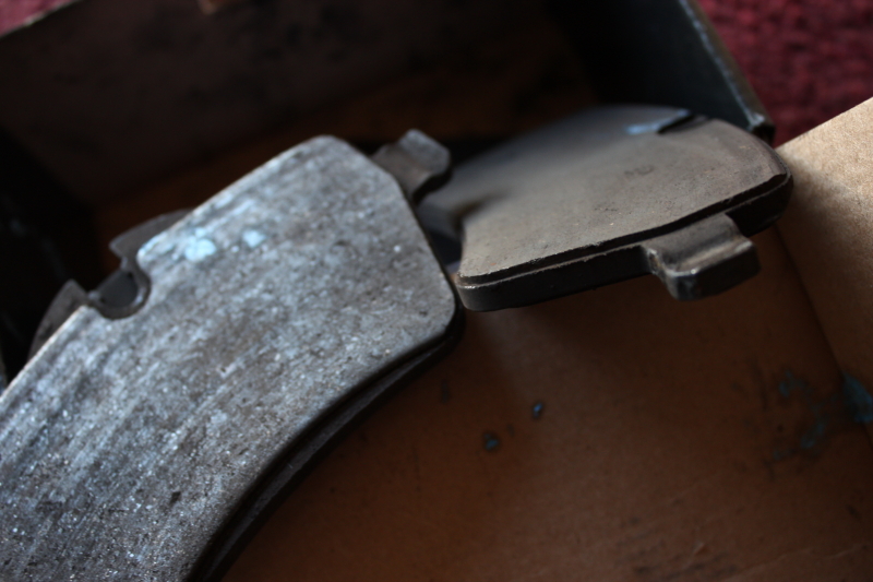

Our car says we should change the brakes within the next 1k miles, but after further inspection it seems that we still have some life left in them:
These are the rear brakes:
Dealer replaced all brake pads 24,400 miles ago, how many more miles do you think we can still go with these?

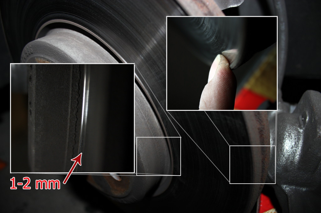

Here is the rotor for the front brakes:
Should I change them for new ones?

Damn you just got them changed 24k miles ago? What the hell are you doing, romping on the brakes every turn? You should be getting 3x the amount of miles on these brakes. Sure change if you want or save up for something better and change the when there is nothing left. Also disconnect the sensors now so that you won't have to replace them when you finally wear them out.

jmo, fronts need to be replaced. Rears can probably go a little longer.

The rears look like they can go another 15-20k and the front another 5k also removing the pad sensors now before the ridge in the rotor cuts the wire will save time and money at the next pad change.

When you see some new pads you will realize your fronts are done.

rule of thumb for any disk brakes
when the pad material is less thick than the backing plate it is time to change 'em
here's a nearly new 07 front, with some white added to highlight the backing plate
and here's a very worn 02 front

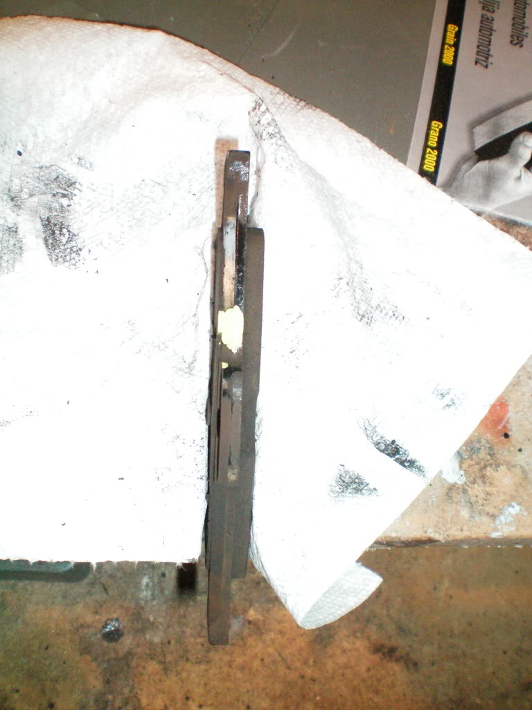

another seat of the pants check for MINI OEM pads anyway, you'll note the new pad has very visible bevel on the edges. Note that when you can't see any bevel anymore you'd be about to the thickness of the backing plate
I'd be replacing the front rotors. I usually go 2 sets of pads to a set of front rotors on the MINI. To get technical the minimum thickness for the rotor is stamped or cast into the metal around the hub opening. But that's a pretty good lip .. time to go IMO.
Good chance you already tripped the front sensor if down to 1000 miles. Here you can see the two 'nubs' left after the rotor broke the wire in the sensor

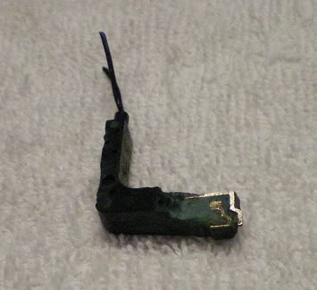

last: only 1 wear sensor per axle, left front and right rear.
ever wonder what's inside the sensor?
the bottom is the part that is against the rotor. this one has had the wire worn off - broken - creating the open circuit.

Is that a fracture on your front rotor?
Yea, replace those pads!!!
Old Oct 26, 2012 | 10:20 AM
PelicanParts.com's Avatar
PelicanParts.com
Vendor
Posts: 7,188
Likes: 71
From: Harbor City, CA
+1...either a crack or accumulated brake dust.
Thanks for the info and pics, I looked into rotors, will most likely get the centrics. No wonder I didn't see the sensor... I don't think it tripped though cuz the warning light hasn't come on yet.

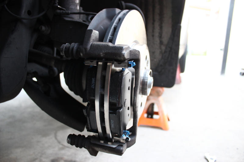

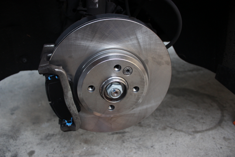

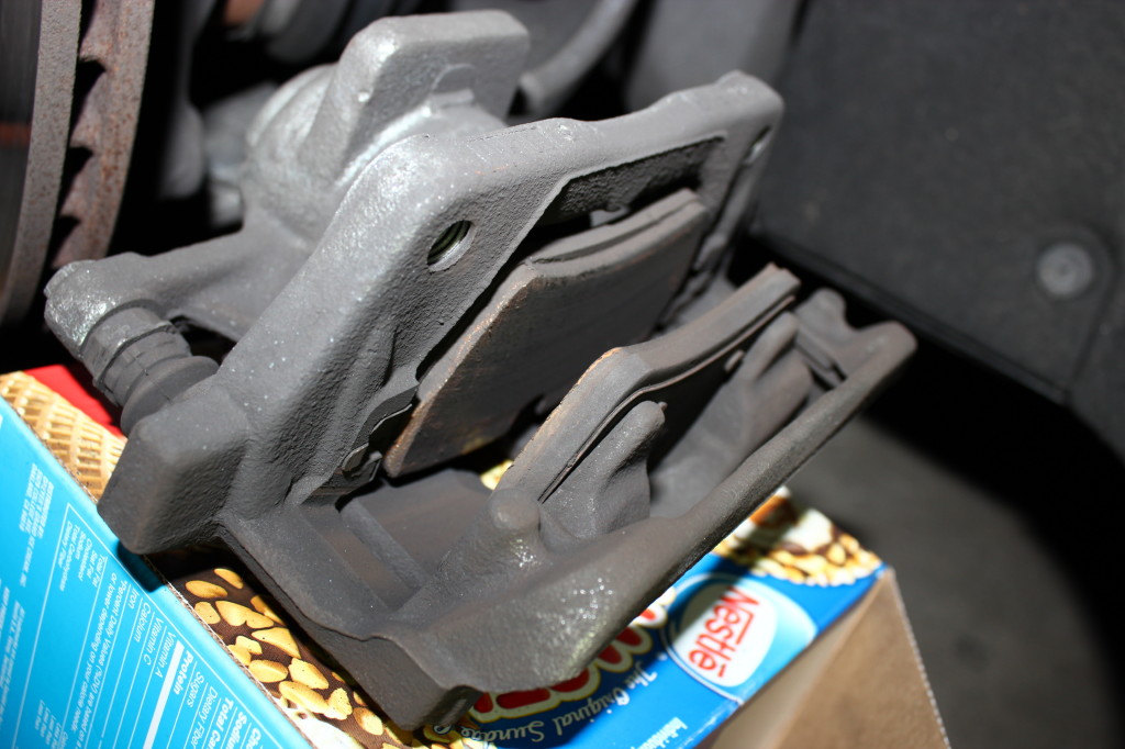

Just to update I replaced the front brake pads and rotors yesterday and we were able to squeeze out another 8k miles
Attached Thumbnails Brake pads & rotors - should I change now??-img_7738_1_1.jpg   Brake pads & rotors - should I change now??-img_7722_1_1.jpg   Brake pads & rotors - should I change now??-img_7727_1_1.jpg
