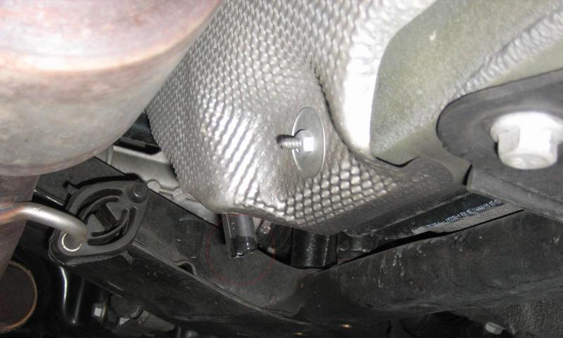

Hey Gang,
Got a curious question. The last few mornings I have noticed a puddle of water under my car. Taste-test does not detect antifreeze or any other unpleasent tastes.
Got my 2007 MCS up on ramps and found the source to be an oblong tube protruding through the exhaust heat shields approx. 2 feet from the rear of the engine compartment (roughly in the center in the pic).
Any idea what this is for and should it be dripping?

Coolant overflow release I would guess. If you over fill, it blows excess out there.

My vote is for the AC condensation tube.

I agree

It is the ac.

Isn't there a drain tube for the sunroof guttering down there in that area?

If it's clear I'd agree with the A/C, if blueish I'd say coolant.
No taste so most likely A/C condensation.

Thanks everyone for your feedback...liquid dripping was clear, not blue.

You can probably see it by opening the hood and looking at the passenger area, between the engine and the firewall. It's the a/c dripping for sure. The radiator overfill and reservoir are located towards the front of the engine on the driver's side.

My vote is for the condenser drain tube as well. When it dries up outside drive around without AC or defrost and see if it is dripping anymore.
