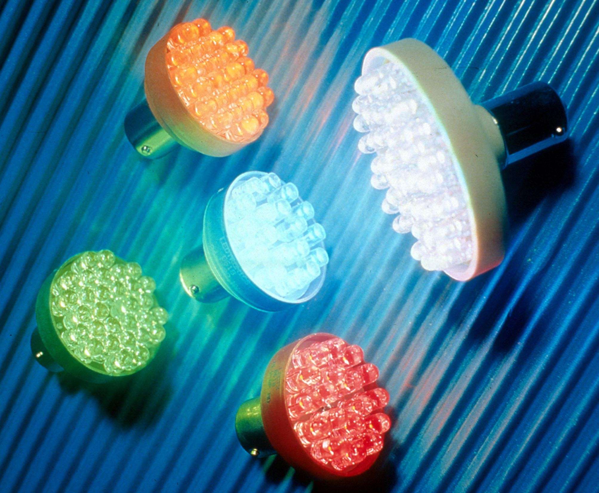

I should have said it differently, but my post was in haste. LEDs do not behave the same as incandescents when power is being reduced (i.e. during theater dimming). Yes, they do dim, but I just don't want mine looking slightly purple or bluish as they fade out, unlike the consistent color of an incandescent. Voltage affects color temperature of LEDs, especially white ones.
I agree about being careful with which bulbs to replace and with what to replace them. I wouldn't recommend replacing incandescents with LEDs unless the LED is specifically designed to replace an incandescent, or if you can verify that the difference is negligible after replacing the bulb.
Basically, if you are replacing an incandescent, the LED needs to be able to scatter light in all directions, instead of just one direction.
Good style (similar to what rkw posted, but notice the lack of heat sink. More on that after the photos):
Bad style:
However, I am not sure about the heat issue. Why would an LED (something that creates almost no heat) require a heat sink? I did research and found that LEDs only require heat sinks when being used in ultra high powered or in high output applications. And much to the contrary, "regular" LEDs (i.e. ones in cars or for use at home) perform better with heat. If you are curious, this and this and this is where I found my info. Finally, one doesn't need to worry about heat from a car affecting their lights, unless they're installing lights directly on their engine other high-heat source. Inside your tail pipes, maybe? Regular bulb locations on a car are low heat.
So... it's really about getting the right kind of bulb. Does 4ae design sell the right kind? Well, at least in the applications that he's photographed. But notice how he hasn't shown any brake lights or turn signals. It isn't perfect... do your homework before you buy them, otherwise it could be an expensive mistake.

No, that was posted by the OP (genik). The link I gave points to Elef bulbs like this. These are at the very top of performance but unfortunately difficult to use in a MINI because of how they must be fitted.

LEDs do generate heat. When people think of LEDs, they usually think of what they see in low power, cool temperature consumer electronics. For LEDs producing the brightness required for tail lights, they can generate enough heat to degrade the LED elements over time. I'll refer you to this, but I've spent a lot of time on an LED hobbyist forum where people often take apart their taillights to build and install custom LED circuit boards. Heatsinking is a frequent topic over there. A project using improper heat sink may burn out in less than a year (and that happens frequently with plug-and-play aftermarket LED bulbs that don't have proper heatsink).
Look at the first production full LED headlights, introduced in the 2009 Escalade. It uses an electric fan to blow air on the cooling fins!

Dimming LEDs is most commonly done either by lowering the current, or through a technique called Pulsed Width Modulation (PWM).
LEDs have a very quick response time (~20 nanoseconds), and instantaneously reach full light output. Therefore, many of the undesirable effects resulting from varying current levels, such as wavelength shift or forward voltage changes, can be minimized by driving the light engine at its rated current and rapidly switching that current on and off. This technique, known as PWM, is the best way to achieve stable results for applications that require dimming to less than 40% of rated current. By keeping the current at the rated level and varying the ratio of the pulse “on” time versus the time from pulse to pulse (commonly referred to as the duty cycle), the brightness can be lowered. The human eye can not detect individual light pulses at a rate greater than 200 cycles per second and averages the light intensity thereby perceiving a lower level of light.
With all that said, the main point I want to make is to be safe, especially with brake lights. After installing LED bulbs, verify that they are bright enough to be seen during the day, and at off-axis angles. I've seen right here on NAM where people proudly posted pics of their LED swap, and I thought they looked dangerously dim.
