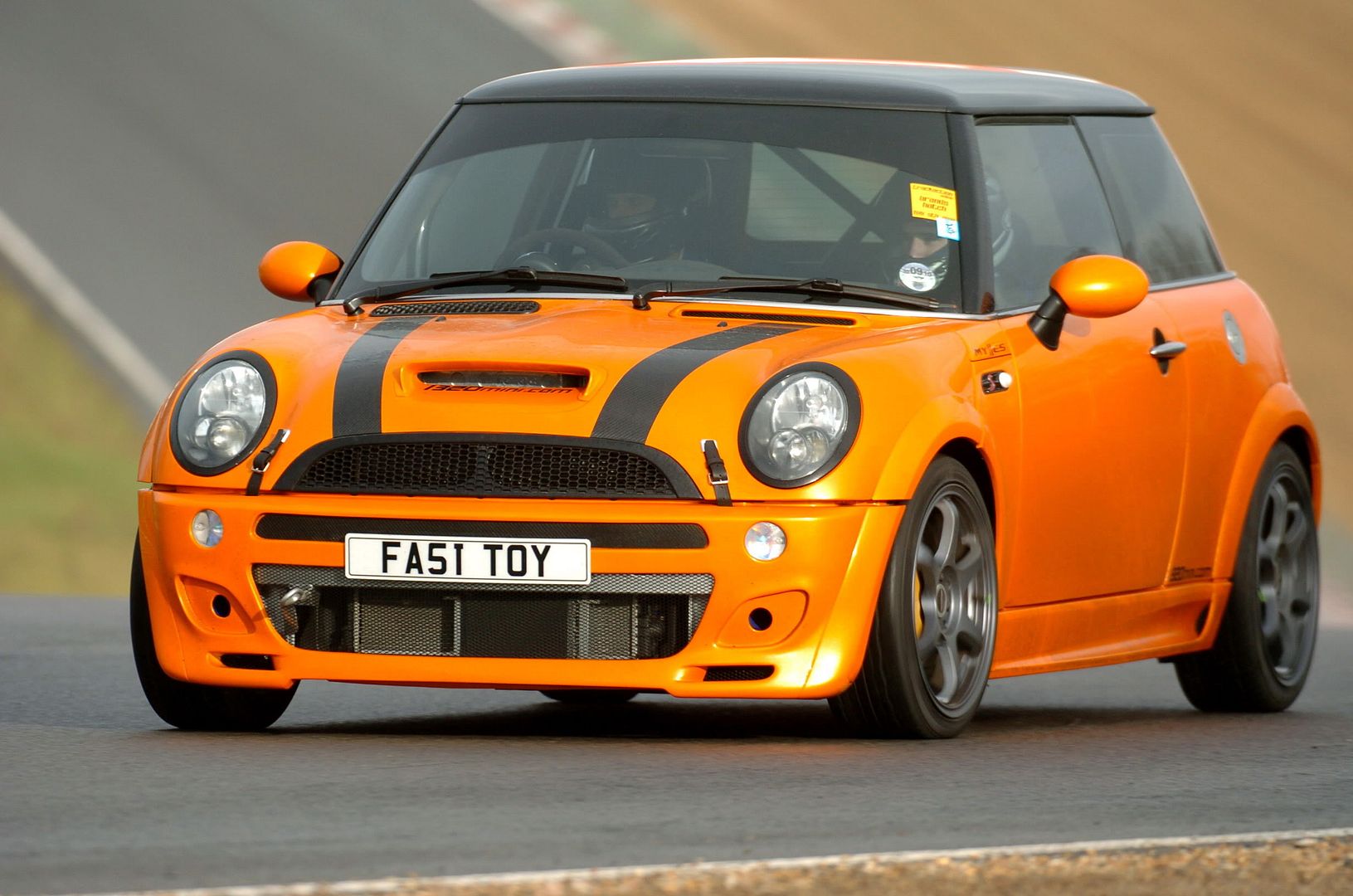

Your car may just beat out my current favorite orange Mini:
Gazkart's Orange One as seen on Minitorgue. Click Here
(Gazkart's is set up for racing, i.e., FMIC, roll cage, stripped interior, etc.)
