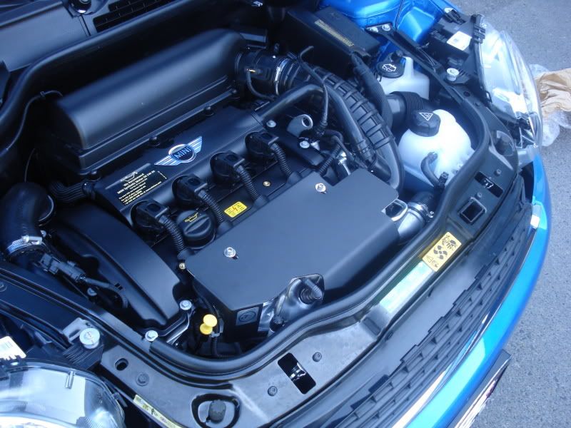

We picked up my wifes new 09 MCS yesterday and drove it down the highway to get home and the first place we stopped was at our mechanics shop. I got out and was showing him the car, we popped the hood and felt the underside of the hood smokin hot! Even on the outside. So hot it was dangerous So I proceded to buy her, her first mod, the M7 heat shield. This thing looks like it came from the factory, if not better It's gotta help. I also plan on dremeling out the rest of the holes in the scoop.

I'm not sure the heat shield is a great solution (or even a good idea), I mean yea it protects the hood scoop but it keeps the excess heat in the engine longer, which could possibly lead to other problems that would not be covered under warranty.
I had my first hood scoop replaced last service (week ago) they said if it happens again they will replace it with the JCW CF scoop free of charge (noted on my service report), which I would be happy with.
As for the OP first statement, it is a functional air scoop on 08+, but still happens.
It's not sealed or anything, it's just a shield. Plus the hood scoop is barely funtional. If you look at it most of it is plugged up.
I know its not sealed, but its still changing how the air is circulating in the engine, and how the heat is being released, just by being there. I'm certainly not saying this will definitely cause a problem, but its certainly a possibility. I would also be fairly certain if anything were to go wrong with the engine that could be linked to excess heat (which is practically anything), Mini is going to deny coverage (or at least have a case to if they wanted) with the heat shield installed. Seems to me to be an awfully big risk to take, just to save a stupid piece of plastic they have to keep replacing anyway.
Well it can be removed in about.....2 minutes, and welcome to the world of modding. Anything aftermarket added has a risk.

JIMINNI: Have you gotten any rattling from the stock turbo shield after installing the M7 shield? I have an M7, but haven't installed it because I don't like removing two out of three screws holding down one edge of the stock shield.

A while back my scoop started showing the start of the "melt". I went to remove it so that I could open the other holes in the grill. In the process of releasing the center mount I discovered it was pulling down quite hard on the center of the scoop. (where the dip was starting). To me it seems that the scoops are not melting from heat but are rather being pulled down by the center mounting clip when hot causing the dip. I pushed my center clip up to release the clip so that the scoop is no longer being pulled down by it. My dip went away and so far no more "Melting" my scoop looks as good as new.
Well its actually still melting, its just the bolt causing the deformity on its own. I'm still not comfortable with plastic that has such a low melting point being used. I mean yea it may not become deformed on its own with a loose bolt, but it still potentially could if some one touched it or something else. The proper solution is for Mini to replace the scoop with something made of better material, and we should have them continually replace the scoops until this is the case.

There was this thread about the heat shield possibly causing the valve cover to warp.

Maybe somebody could put the heat shield on, then drill out holes to let the hot air out and then we could all comment on how well the modded-mod works

Our 08 Clubman S melted a scoop. It was replaced. Have now had a http://www.waymotorworks.com/home.php turbo wrap on for about 3 months, no issues, lots of HARD miles put on it.
The turbo is designed to take high heat, the plastic around it is not.
The turbo cools quickly with a few minutes of easy motoring before shut down, and oil is pumped through the turbo after the engine is shut down.
Oh, and you CAN put you hand on the OEM shield while the turbo is hot, and not need to get skin transplants with one of these wraps.

I've had an M7 heat shield since day one, 6,000 + miles and no melted scoop and no issues anywhere in the engine bay.
I think you're right "but", the retaining pin is keeping the center of the scoop from expanding/warping "upward". And it does look like a "dip" and all of the melted hood scoops look this way, i.e. the center is held down, still level with the hood and on either side the scoop is warped upward.
Did the scoop went back to its original shape once you released the pin?
Yes mine went back to the original shape after a week or so with the pin release. Even after the car sitting and the temps on the scoop at almost 200deg it is not soft to the touch you can't bend it or cause a dip by pressing on it. It needs preasure over a period of time to cause the dip for what I have seen. My dealer told me a one time only replacement and that it's a 2 step process. You have to bring the car in to have them look at it. Then then order it and have to paint it then you come back in. A real pain and the paint will probbaly not total match. As far as i know any replacement will be the same stuff that is currently on the car unless you get carbon which would not look good on my car IMO. So plan is to keep the pin out and hopefully make it to near the end of the warinty then look at a replacement if MINI has changed the stuff or how its mounted.
