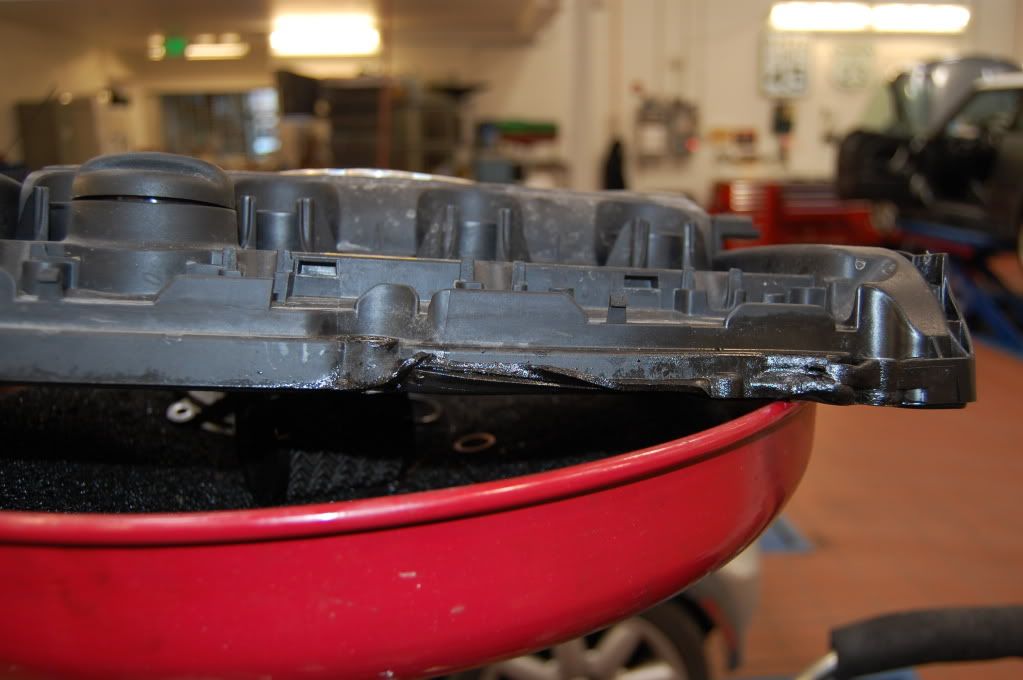

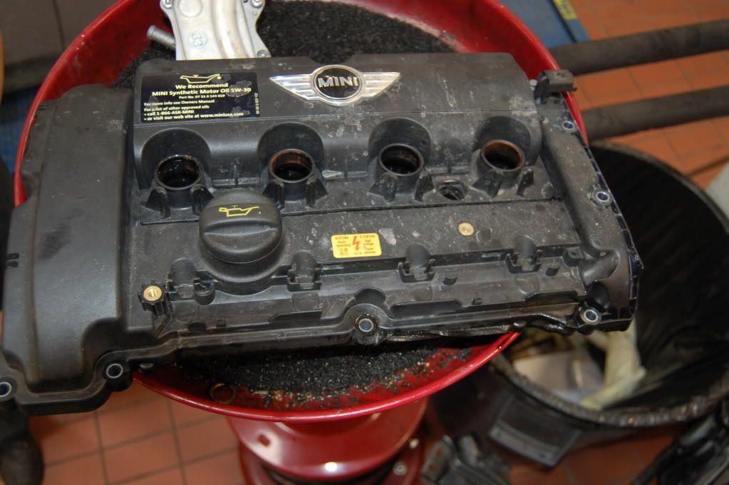

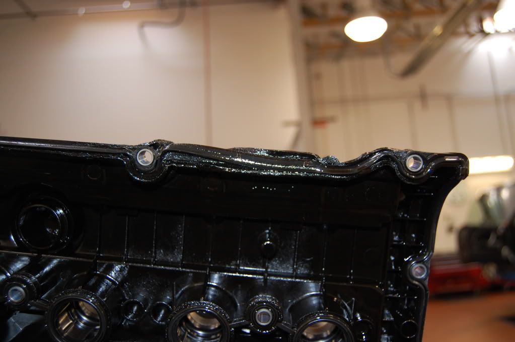

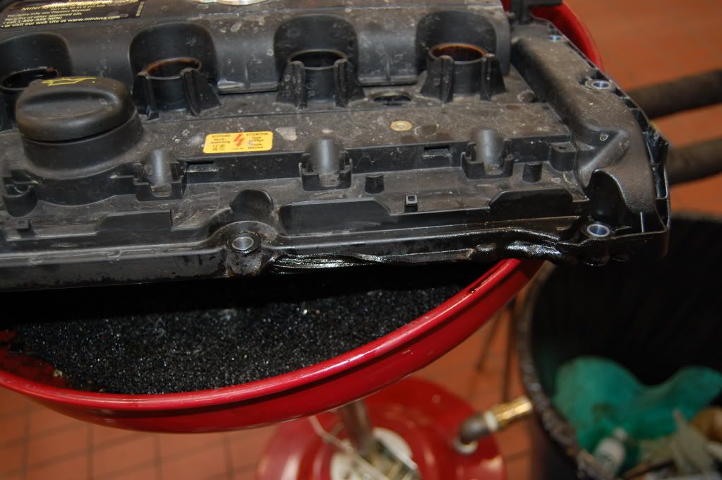

Here are the pics of it. As you can see it has curled up really bad. As for the rest of the valve cover it had a small amount of melt on the inside, but nothing like this. So once again, anybody with the heatshield that has had it on for a while (4-12months) will you please go out and check your valve cover just to see if this is a problem.

Wow, that is really hot... hopefully it is due to your overheating problem, but if it got hot enough to do that, you'd think you were running hot for a long time... not just a short bout of overheating, unless it was significant.

was this the plain metal heat shield, or with the aerogel insert ?

With the aerogel insert. I pulled over right after my check engine light came on. The water temp "warning" light didn't come on until I was pulled over and stopped. By then it was too late. Just goes to show that us R56ers really need a water temp gauge, because depending on the dummy light to come on......doesn't work. My MINI tech said that usually if the valve cover starts to melt its spots in the middle not right on the side like that. But yes it did get hot, hot enough to warp the head. Warranty is covering it, but the heads are on backorder.....of course.
