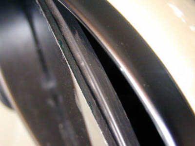

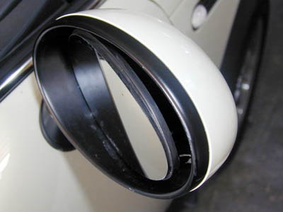

The Multivex was also a bit smaller than OEM on my '06 cabrio (i.e. 1st gen mirror), but not enough that anybody would notice. In this photo the mirror is angled to expose the edge (normally hardly visible). How does yours compare with this?
