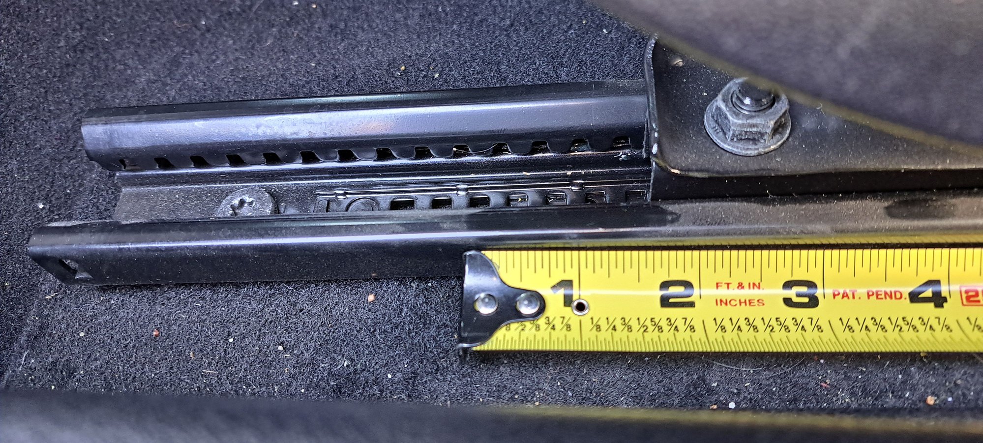

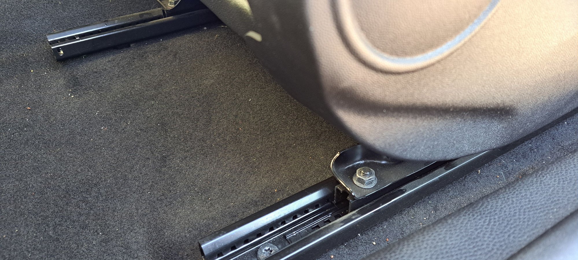

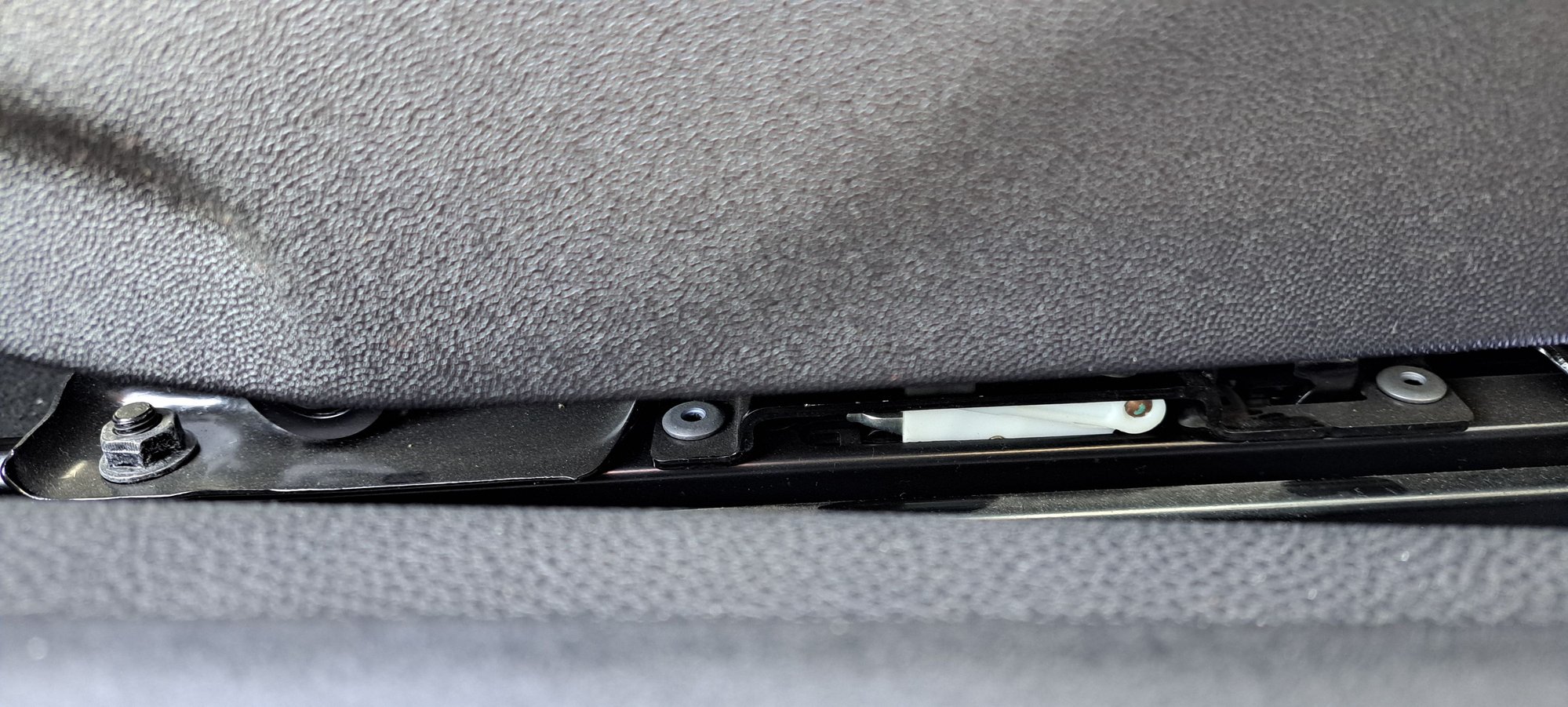

I know I'm doing a throwback here, but I really didn't want to create a new topic for this...I haven't been able to find *anyone* on the web who had exactly this problem. This topic seems REAL CLOSE to discussing my issue. Looking for some help to resolve a problem with the passenger seat on my R58.
My problem is with the seat travel along the rail. It moves all the way to the front, but only moves 1 5/8" back. I've looked for the "shiny metal piece" because it seems like the placement is the issue. I can't seem to see/find what is preventing the seat from moving all the way back. The day it happened I happened to move the seat forward, which I had done less than 20 times previously. I don't see anything broken. Posting pics for illustration.
