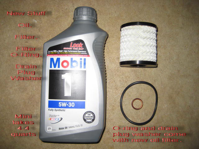

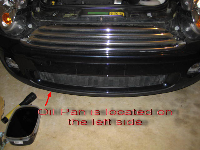

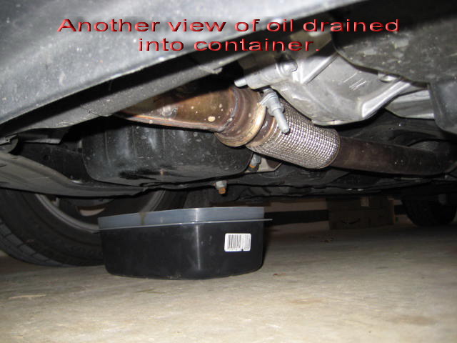

Just did my first oil change at 6000 miles. It was much easier than I expected. Here are pics and some instructions I put together. Hope they are helpful. Pics are spread across thread.
Note on oil used: I used Mobil Fully Synthetic 5w30 this time, since I had some left over from previous car. This will be fine if changing every 5k or so. I plan on either using 0w40 or the Mobil 1 synthetic Extended Life Oil next go round at between 10-12k.

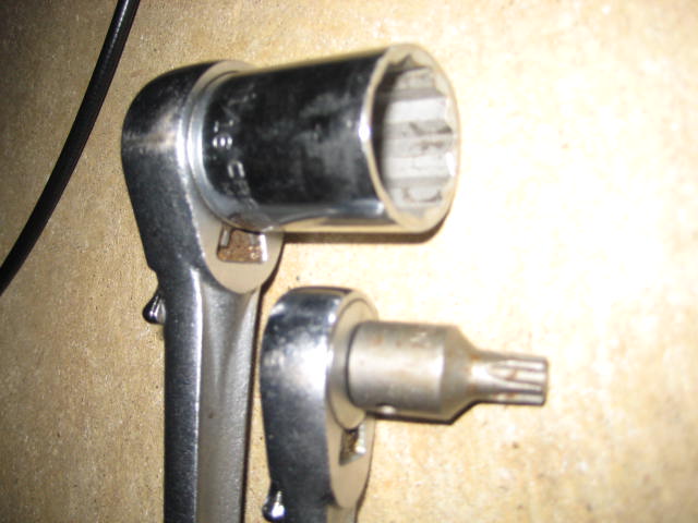

Note on tools: Sizes for the tools are T50 torx on the drain plug and 27mm or 11/16 for the oil filter housing.
Attached Thumbnails DIY Oil Change 2007 MINI Coupe with Pics-diy_07_mini_coupe_oil_change-1-.jpg   DIY Oil Change 2007 MINI Coupe with Pics-diy_07_mini_coupe_oil_change-2-.jpg   DIY Oil Change 2007 MINI Coupe with Pics-diy_07_mini_coupe_oil_change-3-.jpg

set 2
set 2 of pics
Attached Thumbnails DIY Oil Change 2007 MINI Coupe with Pics-diy_07_mini_coupe_oil_change-5-.jpg   DIY Oil Change 2007 MINI Coupe with Pics-diy_07_mini_coupe_oil_change-6-.jpg   DIY Oil Change 2007 MINI Coupe with Pics-diy_07_mini_coupe_oil_change-7-.jpg

set 3
set 3 of pics
Attached Thumbnails DIY Oil Change 2007 MINI Coupe with Pics-diy_07_mini_coupe_oil_change-8-.jpg   DIY Oil Change 2007 MINI Coupe with Pics-diy_07_mini_coupe_oil_change-9-.jpg   DIY Oil Change 2007 MINI Coupe with Pics-diy_07_mini_coupe_oil_change-10-.jpg

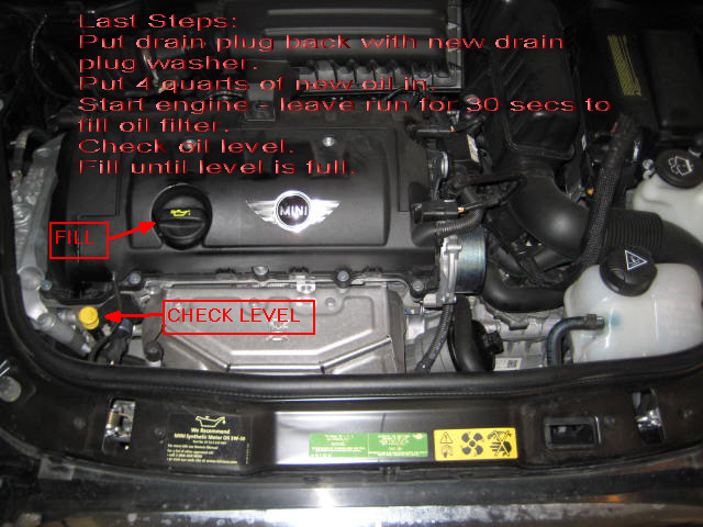

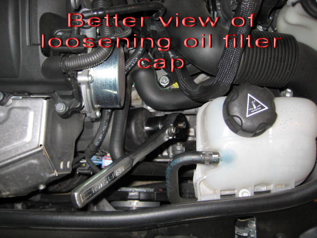

final set
final set of pics
Attached Thumbnails DIY Oil Change 2007 MINI Coupe with Pics-diy_07_mini_coupe_oil_change-11-.jpg   DIY Oil Change 2007 MINI Coupe with Pics-diy_07_mini_coupe_oil_change-12-.jpg

I know for a fact that it's somewhat more difficult with the MCS, just can't say exactly how much. One difference which complicates things over the MC is I believe you have to remove or at least move the coolant tank. Any MCS owners who've actually done the change care to chime in???
Old 01-14-2008, 01:04 PM
glangford's Avatar
glangford
glangford is offline
Join Date: Dec 2006
Posts: 1,113
Received 0 Likes on 0 Posts
I know on my MC you can actually remove the filter cap with an open end wrench it so easy to get to. The MCS is much harder, most remove the coolant reservoir and push it off to the side without undoing hose connections.

MCS only slightly more involved. You need to remove the coolant overflow bottle as it is the access to the top of the oil filter housing. You will need an extender for the oil filter housing as the rachet motion is restricted due to other parts in the way. Btw, sizes for the tools are T50 torx on the drain plug and 27mm for the oil filter housing.
Another hint for drainage. After removing the drainplug, also remove the dipstick and loosen the oil filter housing to just before it comes off. This will allow the motor to drain more thoroughly avoiding the chance of oil draining down the side of the motor when you remove the oil filter housing.
