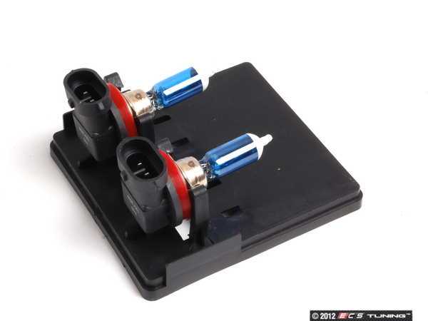

We have not matched them with the PIAA. We know they match with the Ziza fog light in platinum 7500k
H8 Platinum White Bulb - Pair ES2526574
http://www.ecstuning.com/Search/SiteSearch/ES2526574/
So the Headlight H13: We dont carry in 7500k just the ~400k silver star Sylvania.
http://www.ecstuning.com/Search/SiteSearch/ES2019991/
