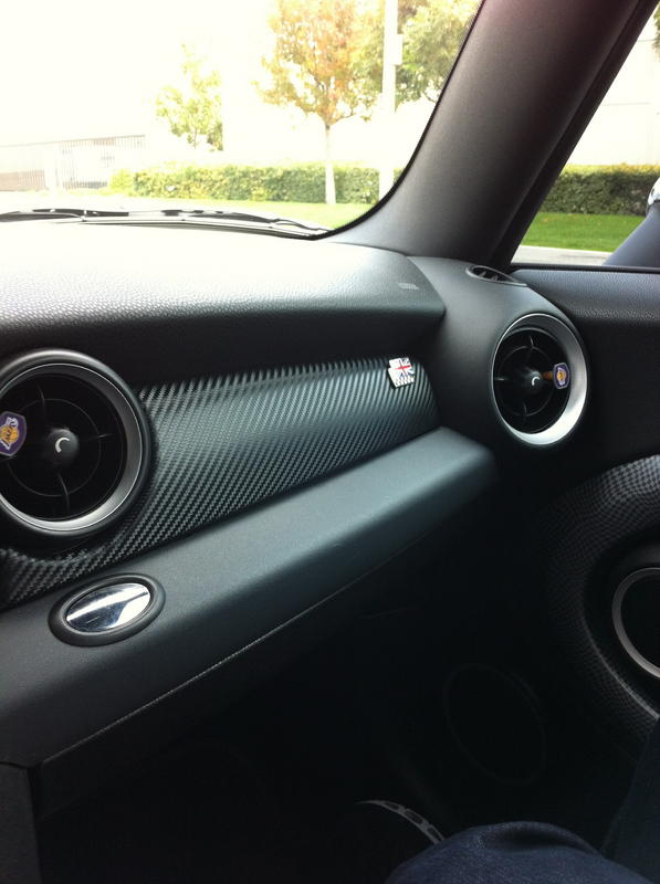

CF Dash trim
Here are a couple of pics of my completed dash....thanks to those that "showed me the way" on the forum!!!
Looking good there and thank you guys for the tips on the car dis-assembly
