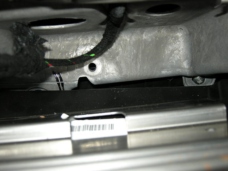

A number of things just bugged me about this install. The first was that the compartment door wouldn't close all the way like it should. Since I already had the routine down, it only took me about 5 minutes to get the dash taken apart again and the compartment removed. Somehow, during all of the wrestling around with the liner this spring mechanism got out of align.
After I got it all aligned, the door closed and opened properly. The next thing that bugged me was a reference to a shorting plug that had to be removed, and while I found a plug on the end of the wiring and removed it, plugged it in and figured that was all, it wasn't No one references the fiber optic cable bundle clipped to the fire wall that has to be freed, and the cables released from their connector.
The bundle is at the rear of the compartment here.
I finally got the fiber optic bundle unplugged from its connector, snapped into the wire connector, and plugged into the interface. From there it was just a matter of putting it all back together, and the compartment door closed with no binding or problems. I turned the Ipod on and then plugged it in, but still no action indicating the Mini sees it. Have an appointment Monday to take it in and get the programing done, hope that cures all. I will post a thread on my equipment and installation later on. IT SOUNDS INCREDIBLE!!! Took it down to Advantage Audio in Norman, OK to get it tuned on their Real Time Analyzer, best money I have spent! They took about 5 hours, fixed some of my mistakes, and just did a first class job!!They are tops in my book!!
