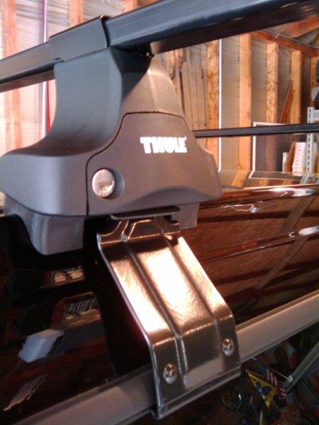

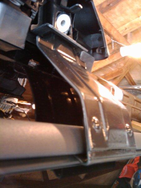

Here are some photos of the successful Thule roof rack installation on my 2008 Clubman S.
I was looking for a rack that was quick to install and remove and that would use my Thule load bars and bike holders.
The feet are the new model 480. They are easy to use and include a very cool allen torque wrench.
The fit kit# is 1507. And here’s where it got interesting. The instructions on how to attach the fit kit clips to the roof were wrong. I was disappointed since I’m a big fan of Thule’s products. I talked with Ryan at the Golden CO store of Rack Attack and sent him a couple of sets of photos. He forwarded them on to his Thule rep. The rep responded with some additional instructions and the install was done. The clips need to clip over the gutters, not under the gasket as shown on the instructions. Make sure to locate the clips exactly as dimensioned in the instructions. The left rear attachment is a bit ugly as the clip pulls the gutter/gasket assembly up from the free edge of the fixed glass. But this wasn’t a deal breaker for me. I just covered the gap with black electrical tape. I won’t have the racks on during the rain. When the rack was removed, all the gutters returned to their original positions.
I drove over 2 hours at freeway speeds (~80 mph) without any problems. The other bike belongs to my brother so he double-checked everything to protect his own bike (a pricy Dean titanium hardtail).
BTW, the bike holders are the Thule Big Mouth holders and are keyed alike to the racks.

THEY WAY YOU HAVE THIS MOUNTED IS INCORRECT.
NOT MATTER WHAT THULE SAID. The Install instruction that I have seen are correct.
There are little pieces of the Rubber Gutter that need to be removed and then that is where the foot clips go into. These pieces are at the top edge of the gutter right along the roof.
The way you have it mounted not only can the rack slide along the roof the rain gutter can be ripped out and then that mean a lot of labor time to have it replaced.
I know what I have stated above to be TRUE as i have worked closely with both Thule and Yakima. MY car has been a test car for them on a number of occasions. Also I assisted them in the writing of the instructions of proper installation.
The clips should attach directly to the metal structure of the car.

That does not look at all like the 1507 kit that they tested my car with the bend up at the bottom is not at the correct angle (bent up to high) and is way longer.
The ones they tested on my car were narrower and the bend was only slightly more than 90 degrees. It fit into the slot perfectly and held of firmly with NO Possibility of movement.
I have seen a few Clubman damaged by racks that attached below the gutter. One to the point of over $1500 in roof repairs because the gutter let go, It is only made of rubber. Another lost a $2700 bike, dent removal and painting of the roof when the racks let go and.
I have been able to move all of the under gutter mount style rack feet that I have seen for this car and all of them will scratch the paint on the roof or roof dunes.
It is your call but IMHO that is a very unsafe mounting method.

I went thru this with the Rack Attack guys. And it was a bit frustrating.
The previous foot model was 400XT with fit kit# 2198 and I thought I had a photo of that kit showing what you described: a narrower clip with maybe a 90 degree bend. But the Rack Attack guy said it must have been a generic detail. He ordered another 1507 just to make sure that he sent me hadn’t been mis-labeled. And it was the same clip.
The instructions for the 1507 implied that it would fit into the factory slots. But certainly not the clip I have.
The Rack Attack guy got this note from his Thule rep after seeing my photos:
“The bracket is designed to fit on that black gutter that runs along the trim above the doors…..tell him to make sure his measurements are correct, but that is the way it fits.”
Do you know a more reliable contact at Thule?
I’d feel more comfortable if the clips engaged the factory slot. But my current rack doesn’t budge.

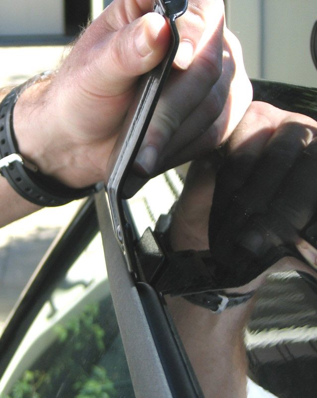

Heard back today from the fit engineer who designed the 1507 clips. This is what he sent me along with the attached photos:
"It sounds as if the customer is trying to installed the bracket above the composite gutter and not below it as it is intended to be installed.
The fit is meticulous, and the rubber is a bit hard to separate from the composite trim above it - but it does work and it does fit quite well.
Note: Make sure they pay attention to the Acutite tensioning tool, as over-tightening this rack can damage the vehicle.
Note: On the back driver's side, you will not be inserting the bracket between the composite gutter and the rubber, but around the rubber itself."
I have sent them a link to the directions and pointed out why I was trying to fit the clips under the gutter. (In case anyone is interested, this is what came with my kit: http://www.thuleracks.com/instructio...07,%201507.pdf See page 6, step 5.)
I'm very satisfied with how the rack mounts on the car after following these directions. It was frustrating that it took this long to get the proper instructions from Thule, however both the customer service rep and the fit engineer very helpful.

Do you have any pictures of your installed clip on the rear driver's side? Mine seems secure, but not so pretty.
I don't quite understand "Note: On the back driver's side, you will not be inserting the bracket between the composite gutter and the rubber, but around the rubber itself."

Here are a couple of pictures of the rack installed. (The quality isn't the greatest as my cell phone has hard time with the lighting in my garage.)
As you can see from the left rear picture, the clip does pull the rubber seal away from the window. I can see this being an issue driving in rain and nothing is preventing water from going behind the seal now. On the right rear, that problem doesn't exist because the seal is different on the club door. Once each foot was properly tensioned, the rack was very secure on the car without bending the gutter. I could grab and bar and rock the car back and forth without the feet coming loose.
Thule's instructions are just terrible... I found is easier to position the feet on the roof without the rails locked in place. Now that I've got the width perfect, I painted a simple white line so I can quickly align the bars in the future. Another thing they don't mention is loosening the tension bolt inside each foot to gain enough clearance so the clip can go under the gutter.
I drove about 40 miles over the weekend with the rack installed and 2 bikes mounted. My maximum speed was about 70mph and I didn't have any issues other than some whistling above 55mph. I don't see any damage to the gutters or roof. I guess only time will tell if this mounting system will be an issue.
