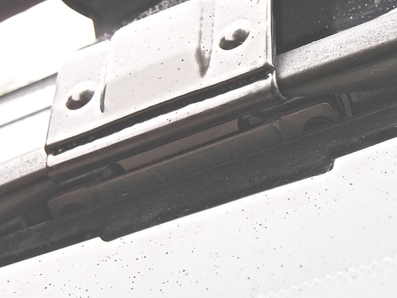

My gutters didn't deform after torquing down the feet. I don't trust the Thule instructions anymore so I tightened the feet until I could rock the car without the rack moving. I found it best to alternate tightening the feet only 1 turn at a time (once you've snugged them). This prevented the feet from pulling each other out of alignment.
Only made one 40 mile trip with 2 bikes mounted and I didn't have an issue. Could you post a picture of your gutter?

The driver's side rear is the non-typical condition. My gutter pulled up but went back to the original position when the rack was removed.

Here are photos of the install and the close-up of what happens to the driver side rear mount. Sent to Thule for comment. Saw little deflection of the actual gutter but then again if mounted correctly these are at the mounting points for the OEM roof rack.
The biggest issue for me was noise. The OEMs are too noisy and no option of a fairing (without customization). There is no need for the bar cross section to be as large as they are and then the OEM bike racks with the large flat fronted clamp closer makes things worse so a faring would not help much. The car might not have a drag coefficient of .27 but there is no need to exacerbate things with chunky clunky roof racks and accessories.
