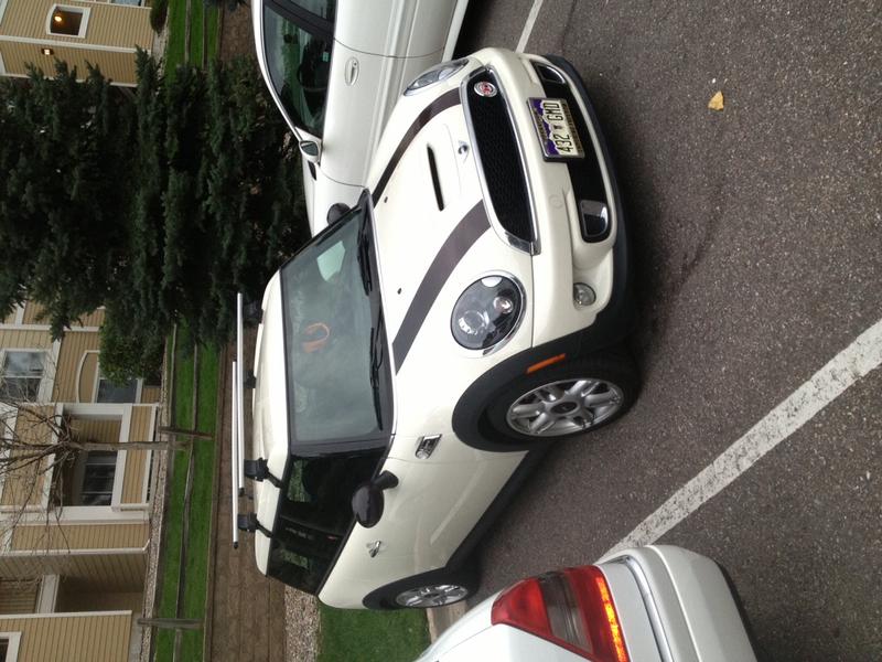

I noticed everyone mentioning how their Thule 1507 fit kits were pulling the weather stripping off the driver side window and one person even put electric tap between the fit kit and the window. I thought it was very simple I just put a very small incision in the weather stripping directly adjacent to the rubber gutter and it looks great. Here are pictures of my Thule rack including were the fit kit meets the rear driver side window.
Attached Thumbnails Thule roof rack installed-photo.jpg   Thule roof rack installed-photo-1.jpg
