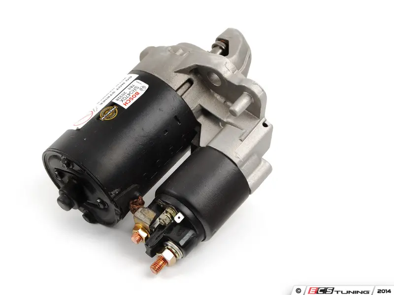

I'd err on the side of caution and replace the starter. If it hasn't died yet, it's old enough that it's on borrowed time. I had a similar issue with my 2005 R50 a couple of years ago and just replaced the starter outright with a Bosch OE unit and haven't had any issues since. Good luck.

That cooper woven strap in between the starter and solenoid rusts and falls apart, its not coated or anything.
I fixed mine once and then used grease to protect, it then rusted more and broke again. :( I just replaced the starter with new and greased heavy on that wire on the outside. Been good ever since.
