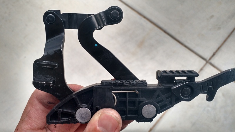

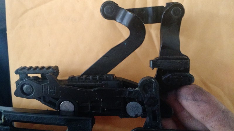

Update...
I am hoping someone can come up with a solution to replacing the pads on this mechanism. Perhaps you have one you thought was junk lying around from a previous repair OR you are more creative than me and could think of a fix???
Last week I decided I wasn't going to be able to repair this part since it was broken in two places. I found a Mini parts supplier that was able to sell me a single mechanism for a reduced price! Boy was I excited...
Until I started the install just to realize this "brand new" sliding mechanism was ALSO missing the same pads I didn't have in the first place...
These pads seem crucial as they hold they preserve stability in the slider as it moves along the rail. On the replacement they just aren't there!
I purchased this part from Mini World of Sun Valley, CA and am very unhappy. Their package was several days late AND as far as I can tell incomplete but I'll reserve judgement.
Here is a picture a CORRECT sliding mechanism. Notice by my hand how it has pads on both contacts where it slides along the rail of the convertible top. The pads near where my hand are MISSING on the OTHER side
Notice on the left of this image how there are no pads. You can see where there used to be pads but when the mechanism broke they came apart and fell off. Please note this is not the one Mini World actually sent me but gets the point across of what is missing!!
These pads seem crucial as they hold they preserve stability in the slider as it moves along the rail. On the replacement they just aren't there!I purchased this part from Mini World of Sun Valley, CA and am very unhappy. Their package was several days late AND as far as I can tell incomplete but I'll reserve judgement.

Looks like a used one , the new ones comes with the pads and everything and are sold in pairs ( new ), there was a redesign in the cables in 2006 from the 2005 version. The 2006 design is updated with those dual pads instead of a pad and a roller.
They are replaced in apris for the updated design and also incase one side is stretched.

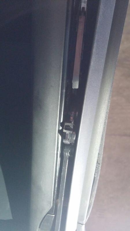

I'm back to bother you
So I got the latch repaired by a mechanic here. So when he put everything back together, he found out that one side of the roof (on the passenger's side) gets obstructed by the head rest on the back seat. Even though opening and closing of roof is working now, it is scratching the cloth on the top and back of the rear seat both ways. I'm afraid to open or close the top now since it is tearing apart the cloth on the top. Do you know what might be going wrong here ? Please let me know if I didn't explain properly what's going on.
Appreciate all your help !

Its ok, I am here to help.
Its the adjustment on the top ( sunroof ) , the sunroof has to slid back evenly on both sides. This right before the top moves back , both side move back again for a second or two. The sunroof portion then goes all the way back with the top. The front of the top then clears the rear roll over bars by a inch or two, then sets folded up in the back.
I think you need to have them reset the cables so the top it even when closed and perfectly even when the sunroof slides back, sounds like the adjustment it off and 1" on one side.
I would have them recheck the alignment. I would also have your local indy call local MINI dealership and have the talk to the service, they usually are very nice at explaining how it works , its best with a phone call to them.
