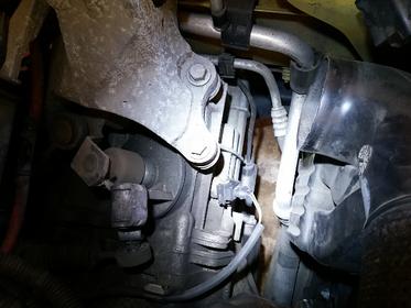

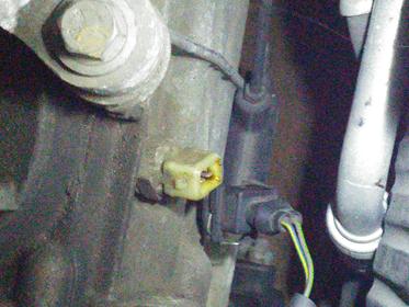

Lol...this is true. You were correct, right under the air box. I sprayed a small amount of penetrating oil on it and will change it this evening. I noticed when I unplugged it, the connection was saturated with what looked like trans fluid.

Replace your reverse switch. I replaced mine and now have backup lights and the PDC works as well. Easy job; 30 -45 mins.
