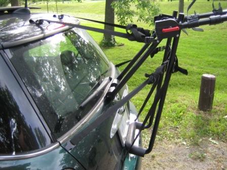

After a lot of paint chips discover have 1 winter only, and the transmission who is making a weird noise by cold weather when I stop, I got a bad surprise this weekend when I removed my Bike rack that I use for 8 years on 3 differents cars.
Bike rack: Rack1.JPG

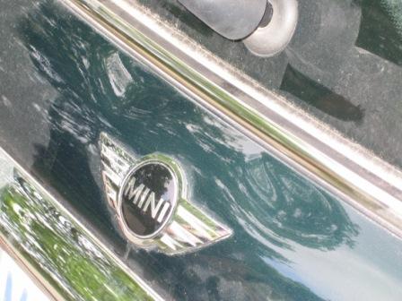

After I removed the rack, 2 dents created by only the weight of 2 bikes:
Any body got any issues with the cheap body on the Mini?

Cheap MINI body? I disagree. This sort of damage could have also happened on a new Honda, which are known for their thin sheetmetal and paint.
It seems to me that you are using a bike rack that is not approved or suitable to use in the MINI. I find it a little hard to believe that you don't expect to see damage on a part of the tail gate that is clearly not designed to withstand the weight of a bike rack plus 2 bicycles.
Sorry to sound a little harsh but I think you need to find a bike rack that does not press its weight against the hatchback. If you look at OEM bike racks or aftermarket ones (Like MINIFINI's) you'll see that none of them rest their weight against the back of the car.

P.s., MiniToy, you installed your bikerack incorrectly....the top arm is supposed to rest on the window.

MINITOY can have his dents fixed for around $150 at one of those mobile dent (PDR) removal places. Painful lesson to learn.
I am not a big fan of the OEM roof rack but it so happens that the manufacturer has deemed the roof as one of the safest places to put your bikes. The other such place is the rear bumper structure.
Sorry, the MINI was not designed to be a bike hauler right out of the box, so your "safe" choices are pricey and require holes to be drilled. If you deviate from these requirements, you'll have problems. Post #1 is a clear exhibit as to why researching these add ons is so important before putting them on the car.

I use the Saris Bones rack; it cost about $110. One arm rests on the window glass, and the bottom arms rest on the bumper. I use a pad on my bumper between the arms and the bumper and while it does dent the bumper a little (they can only seen at the right angle), they pop back out after a short time. I don't know what the rear bumper is made of, but it isn't the metal the body of the MINI is made of. No permanent damage to the bumper after using it for a year on my MINI. No holes need to be drilled. The rack pops on and off in 2-3 minutes.
