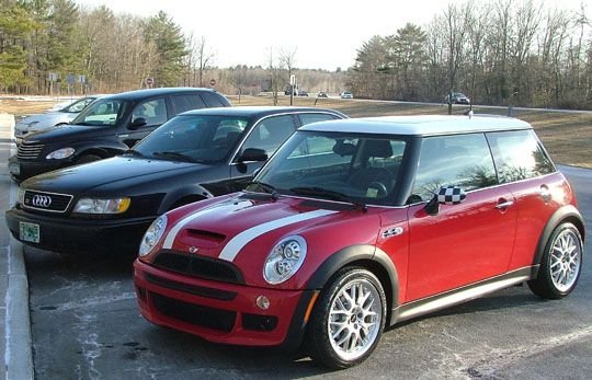

I ordered a 2006 MCS on Jan 21st and added the front aero kit then to the bottom line [along with BBS R90s, and JCW airbox]. Arrived into port Feb. 23rd, then to Keeler MINI on 28th. My Cooper S arrived with the OE front spoiler on and chrome/painted grille [I still have these]. Yes, the dealer installs and paints the aero kit parts, not the VDC. You can specify whether you want painted wheel arches, but I would imagine this costs extra as the labor involved and paint is more. I don't think that there is anything different about the 2006 aero kits. Although, I had to specifically request and order the fog light blackouts on each side.
The factory specifies using a specific structured paint for the grained surfaces to match the fender flares.
From the Aerokit factory PDF...
Structured paint:
0.5 litre #51 91 0 027 551 (MINI structured paint black matt)
1.0 litre #51 91 0 027 552 (MINI structured paint black matt)
One plus about retaining the stock side skirts is the factory front mud flaps bolt right on, as opposed to not fitting on the aero side skirts.
Here's my setup for comparison.
