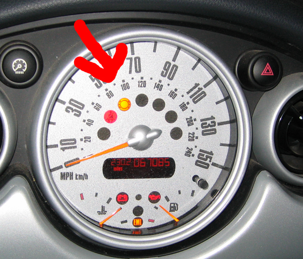

I had this warning light come up on my dash today, dont know what it is and it is not in the manual. Anyone know what it is??

brake pad sensor

They must have changed the display because mine is different, but I was thinking the same thing.

So that would go before the "BRAKE" indicator on the tach signals?

yes the "BRAKE" light on the tach is if you have the E-Brake level pulled. Other is if the sensor in the pads has been worn off .. mean new pads and sensor needs replacing.

Yea mang, your brake pads are worn out. I noticed you have 67,000 miles on your MINI...if those are the original pads, it's probably about time to replace them! Is yours an '03?

According to P.16 in the MC/MCS 2003 Owner's manual it is as everyone else has said.

2003 MCS, pads were last chagned at about 35K miles. Thanks guys!

Yeah, I wouldn't be surprised if there was absolutely nothing wrong. I have gotten to the point where I ignore most of the lights on my car.

Brake Pads

Most likely they only replaced the rears. The fronts were probably still good at that point.

Definitely check to see how far down the backs are. I recently replaced my pads. I replaced all around, after looking at the new pad, and the old back pads, they were only about 25% gone. Wish I would have just skipped the back replacement. Just didnt think to check.
