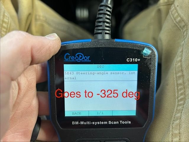

DSC & Flat Tire light came up on the dash. Codes were as follows:
Able to clear all the codes with C310+
Two lights come back on the dash with a few minutes.
Now it's just the SE43 Steering-angle sensor, internal OR SE40 Steering angle implausible. (I've gotten both errors over the last couple days)
I'm able to read the live data stream for the SAS on my Creator 310+ and when I have the steering wheel straight it comes up -172 degrees (should be zero) and reads the steering angle for a few seconds. Then (doesn't mater if I turn the wheel or not) it goes to -325 degrees and stays there. If I reload the data stream (go back a screen and then select it again) it does the same thing... shows a live data read out of the steering ~ incorrect angles but actual readings as the steering wheel is rotated the numbers increase and decrease, so it is giving data but then it goes to -325 and stays after a few seconds and stays at -325 indefinitely
I can not reset the SAS angle to zero with the C310+
I am unable to reset the steering angle sensor by ~ turn steering full lock left → hold 2 seconds → full lock right → hold 2 seconds → center.

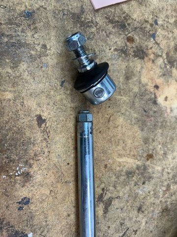

My NT510 still hasn't shown up so I decided to put the Mini up on stands and give the suspension a look see.
Found this on the FR... I guess I did take a pretty good shot on the bumps going to the coast.
Front Sway Bar end link.
Everything else under the car looked OK so I'm going to get a new end link and do a full alignment.

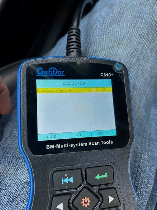

Update:
As I was re-installed the SAS today, I had an idea.
My C310 scanner will read the angle of the sensor as a live feed (for a few seconds then it times out to -325 degrees for some reason)
Anyway I plugged in the SAS, and set it to 0 and then slid it on to the steering column with the steering wheel straight.
Cleared the codes and drove it around the neighborhood. (I still have to fix the end-link on the front sway bar)
No errors so far!!!!
