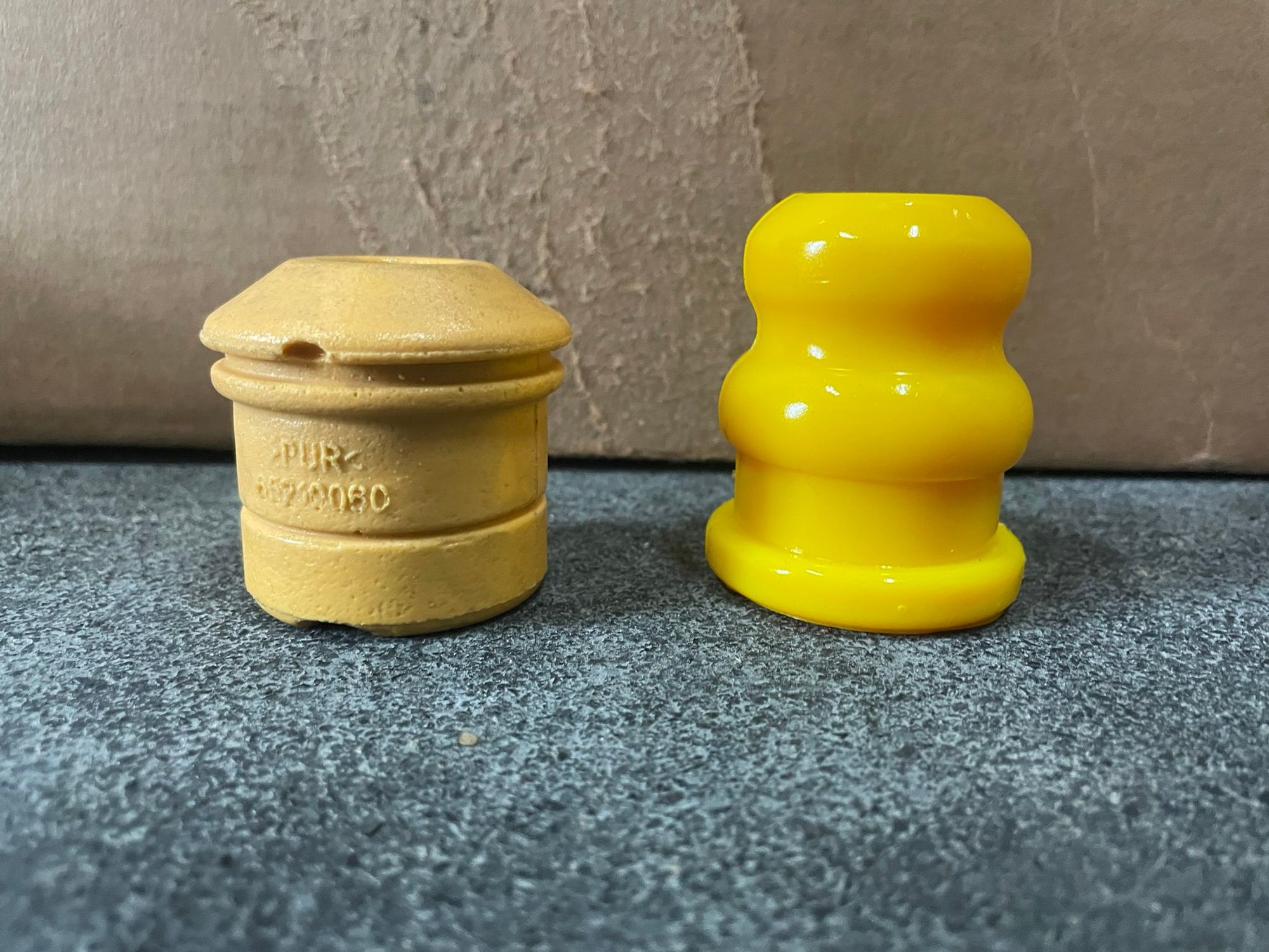

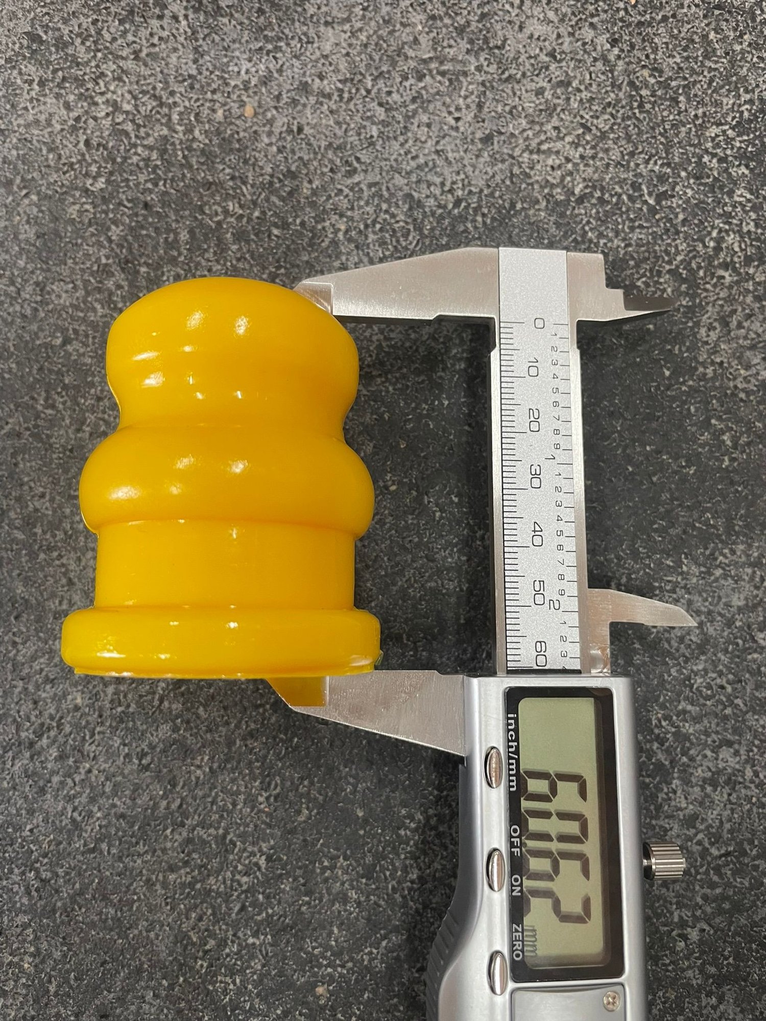

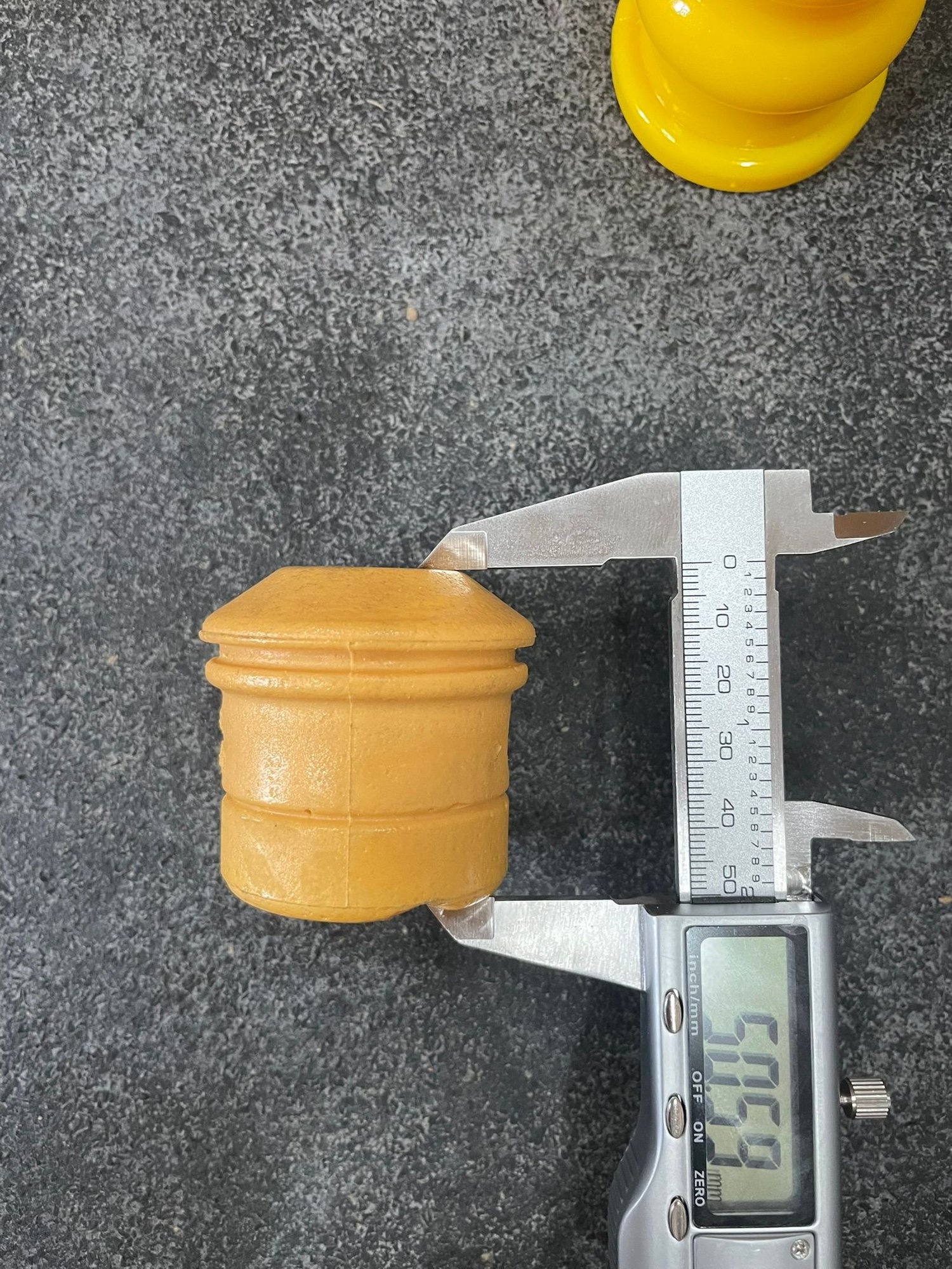

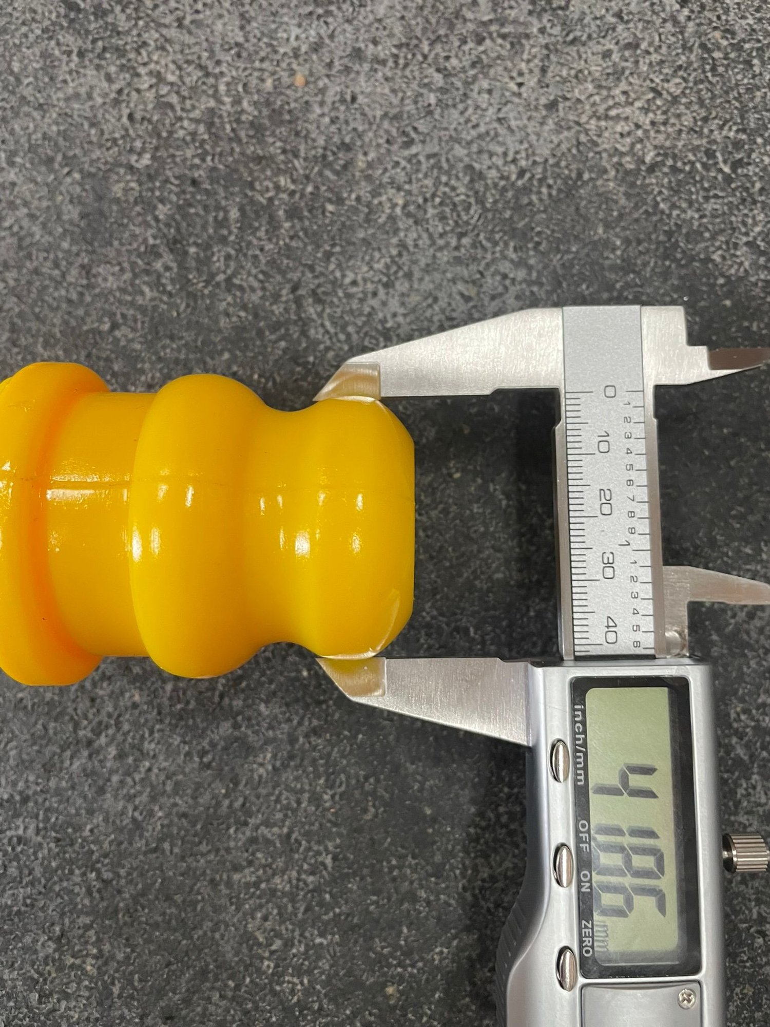

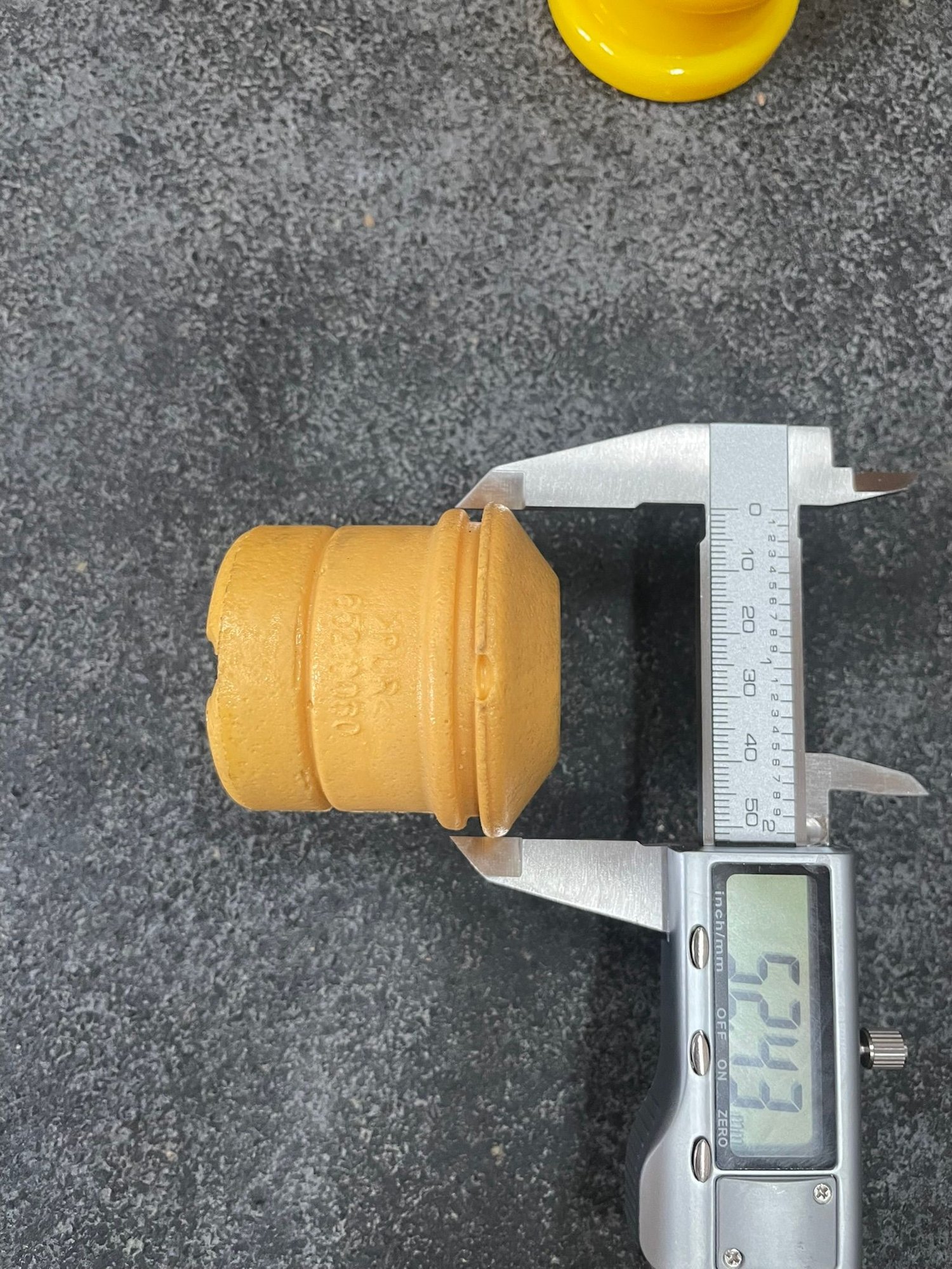

received new bump stops from KW and PowerFlex. Which ones would yall use?

My guess: The Powerflex poly are going to be slightly stiffer when you hit the bump stop but will last longer. The KW ones will probably be a little softer but, like the last set you had, may break down quickly if you are bottoming out and hitting hard on the bump stops.

Personally - Powerflex.
Those KWS still look like the typical foam rubber ones that have a tendency to breakdown in a short amount of time.
Since your Mini is lowered, you may still have to cut the bumpstops down a bit. If you cut them both - You will automatically see the difference in density and material.

thank you both. i think i will go with the PowerFlex ones. I'll probably cut to match the height of the KW's.
